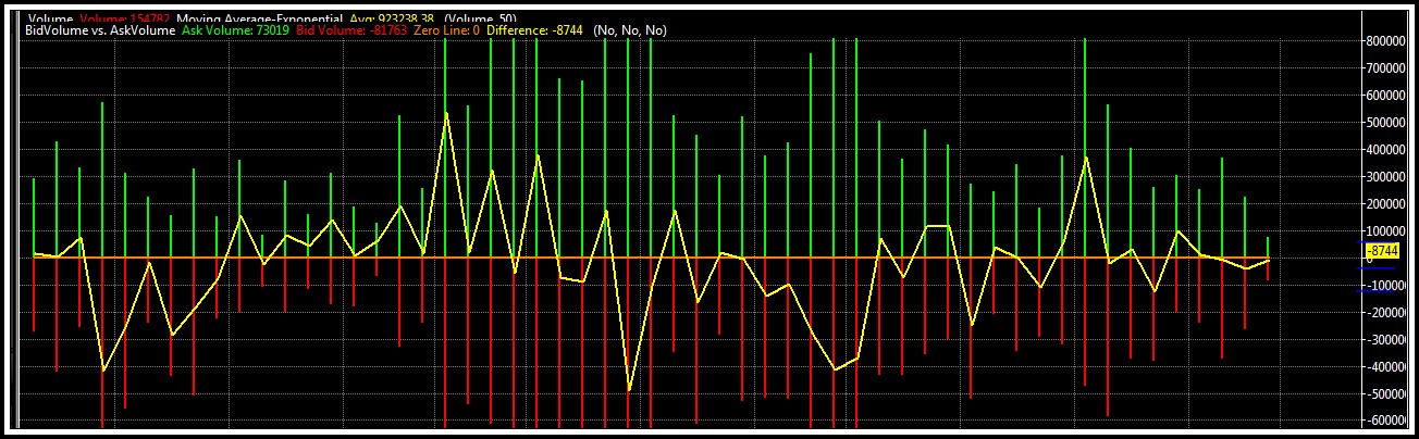

The Stealthy Trader - Posts: 190
So, here's an attachment of the study. I've added the blue lines on the Y axis.
As per the reason for this is I'd ideally like to be able to gauge the rate of change of this indicator on the Daily time frame.
All I can ascertain now is where it is presently.
I could study the 10min or 1 min time frame and try and figure that out.
But I'd like to know how fast the yellow "Difference" line is moving in either in a more positive or negative direction.
I've attached a screenshot and used the Private setting..have no idea if that worked..let me know.
Let me know if this helps..
J.
Private File
[2014-02-22 16:17:18]
vegasfoster - Posts: 444
I can't see your private file, but I have attached a chartbook of what I think you are trying to accomplish. You will need to change the symbols and go to the 1 renko chart and replace the macd with your study and change the settings of the high low snapshot study to your study. After you look at it, let me know which way you want to go with it.
I do have one issue where the function I am using to identify the index of the bar X minutes ago is not searching before the current session, it is stopping at the first bar of the session. So, for example, if you have the session times set to 9:30 to 14:00 and you start trading at 9:30, then the study won't work correctly in the first 30 minutes. If you have the session times set at 00:00 to 23:59 and you trade from 9:30 to 14:00, then there is no problem because the study will calculate correctly starting at 00:30. Let me know how you have your sessions times set. If it's a problem, then I will have to get help because I can't think of another way to do it.

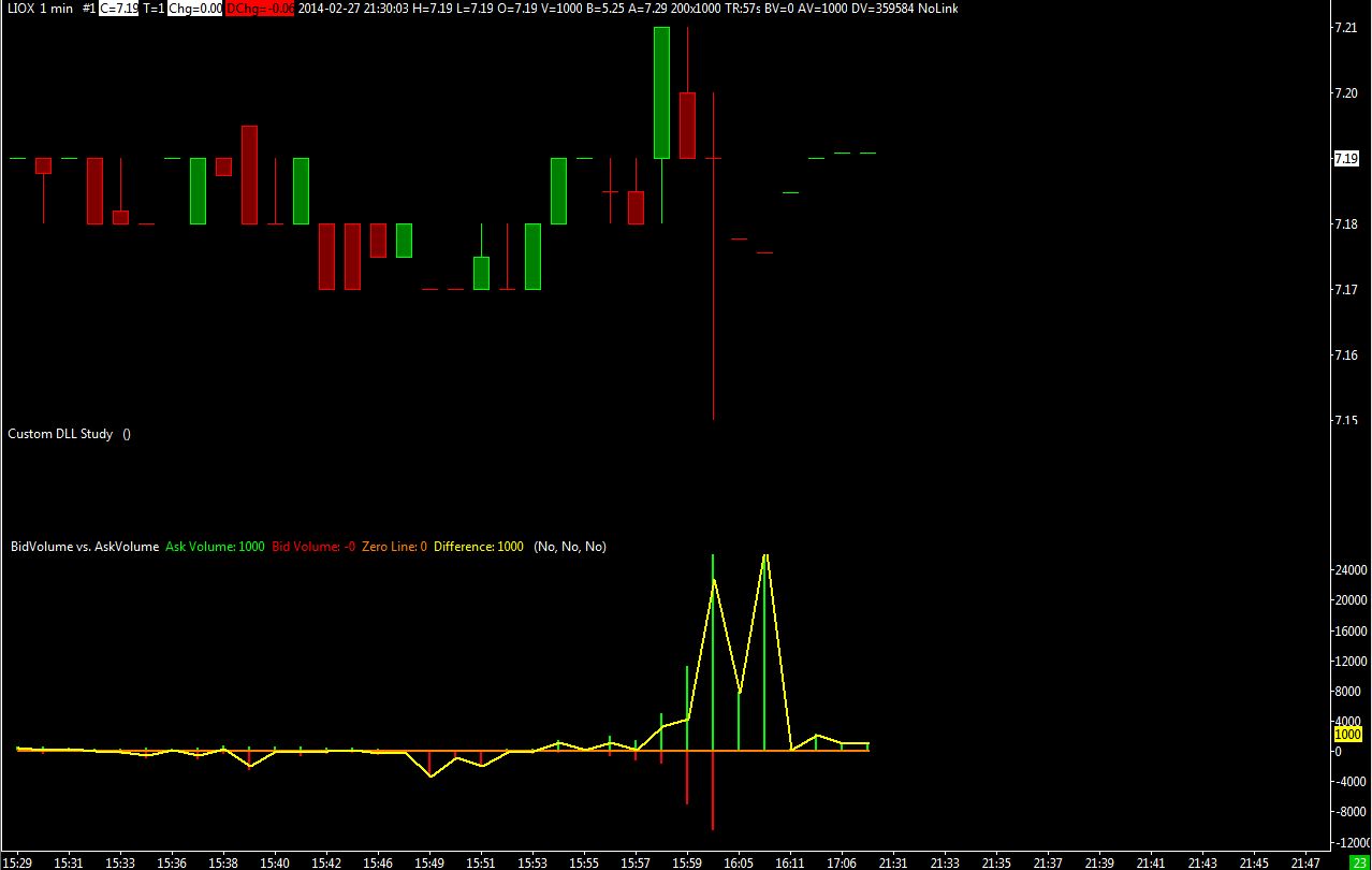

[2014-02-28 02:45:49]
So, I did that and when I open the chartbook and swapped out my study for the MACD, as the screenshot I'm sending back shows, I still don't see anything unusual or new.
Just a chart at the top, something called a Custom DLL Study in the middle space which is empty and my study at the bottom which looks like it always does.
What am I missing?
J.
imagescreenshot for Vegas.jpg / V - Attached On 2014-02-28 02:44:49 UTC - Size: 71.07 KB - 676 views
[2014-02-28 22:16:15]
You don't have the study, sorry.
attachmentHighLowSnapshot.dll - Attached On 2014-02-28 22:16:05 UTC - Size: 15 KB - 794 views
