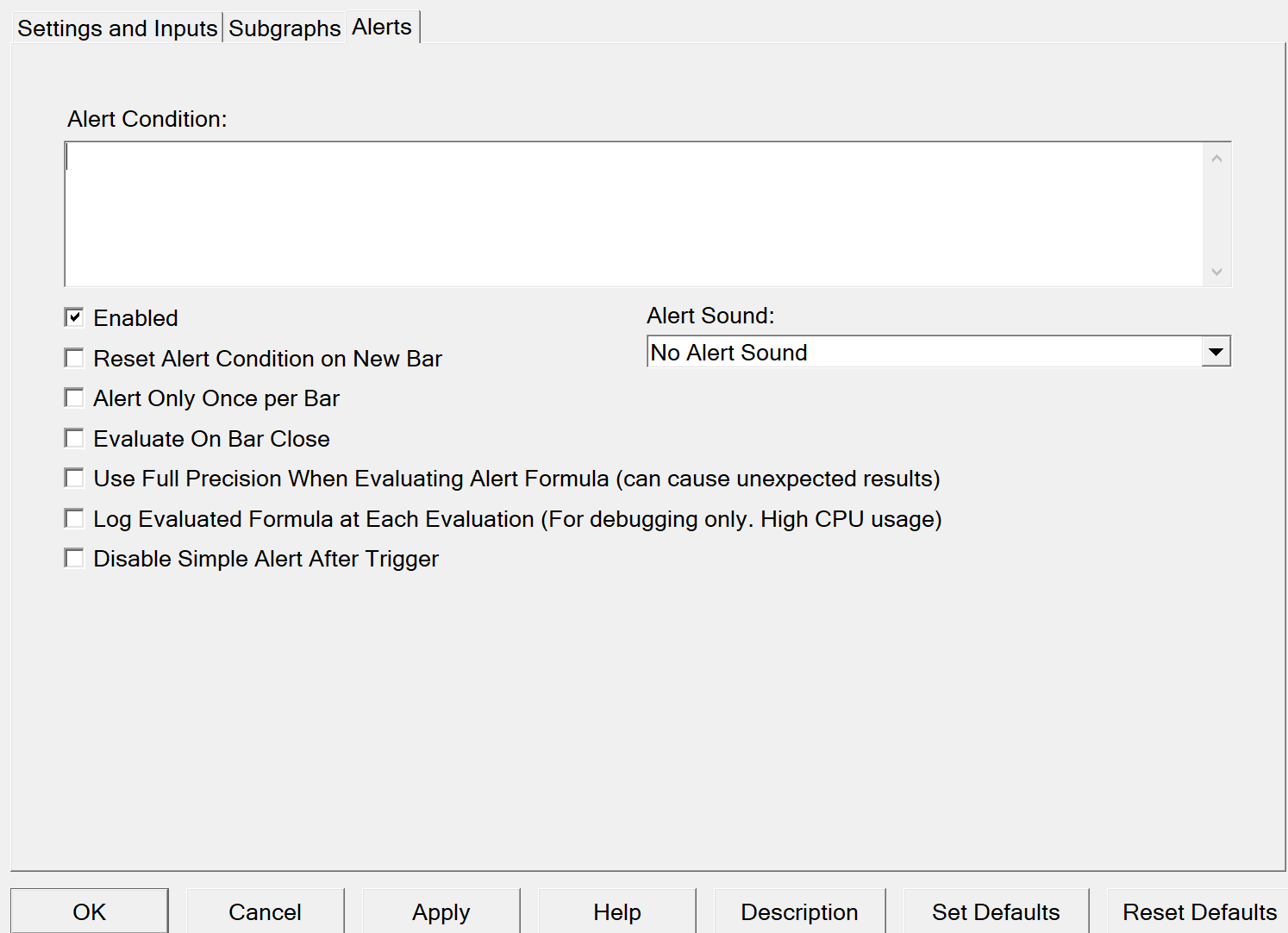

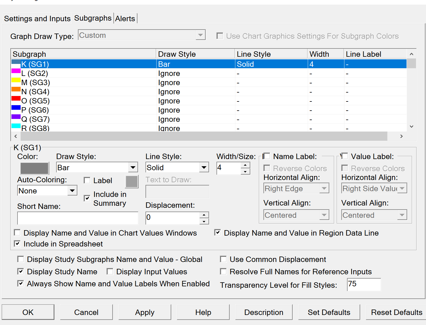

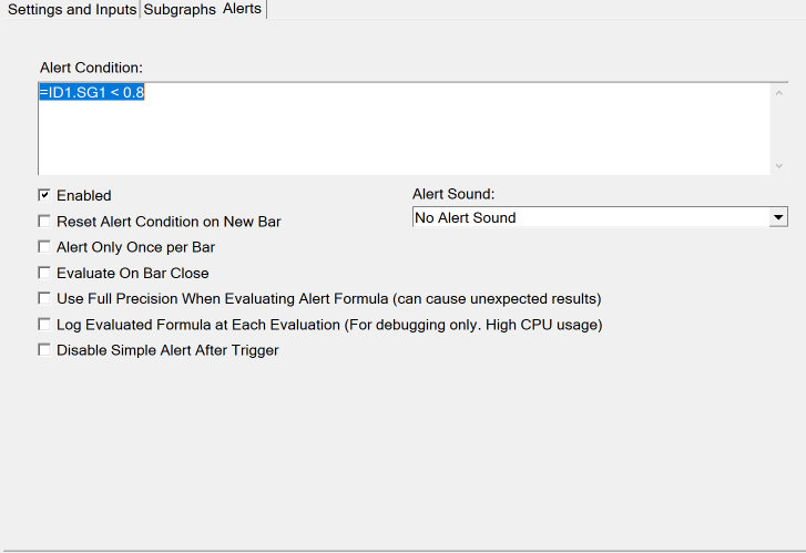

[2020-11-18 21:27:46]
User120086 - Posts: 7
Thanks for looking into this. Please see attached.
imageScreen Shot 2020-11-18 at 2.23.55 PM.png / V - Attached On 2020-11-18 21:26:40 UTC - Size: 85.11 KB - 494 views
imageScreen Shot 2020-11-18 at 2.23.16 PM.png / V - Attached On 2020-11-18 21:26:55 UTC - Size: 193.47 KB - 438 views

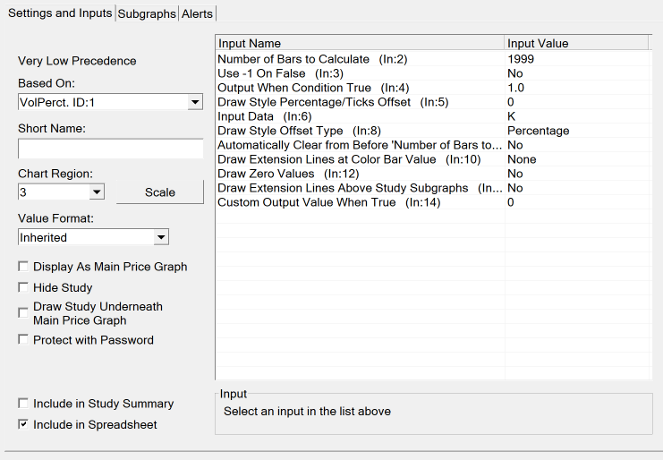

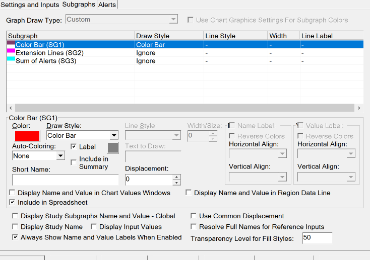

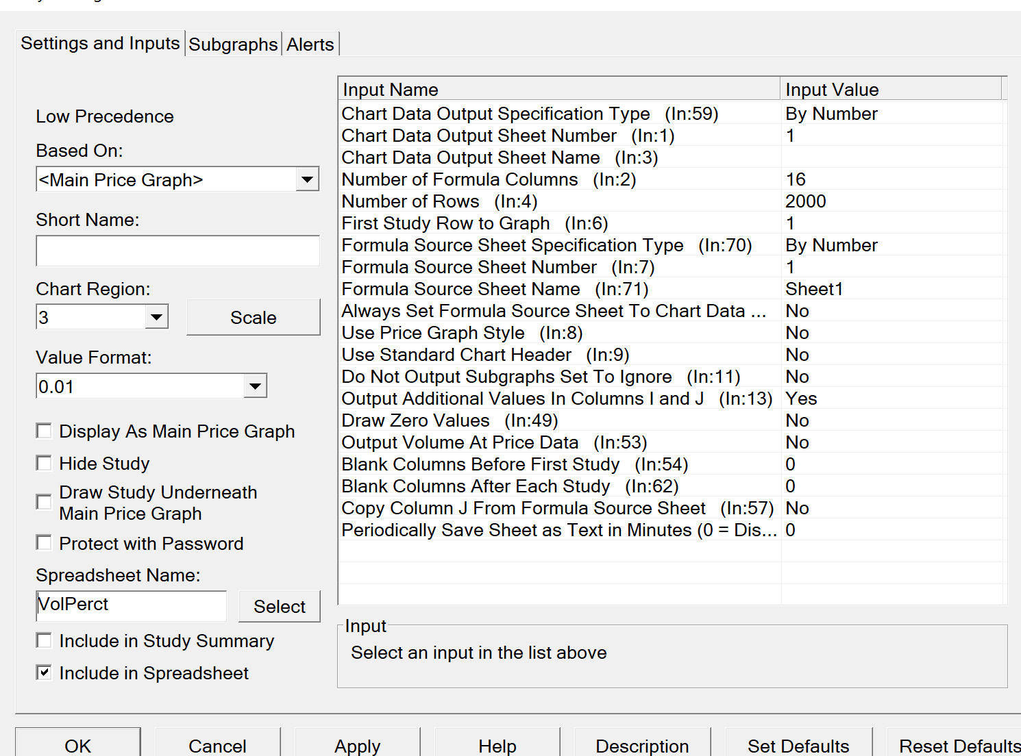

[2020-11-19 13:49:42]
My apologies, I just realized that I sent you the study upon which the Color Bars Based On Alert Condition study acts. Please see additional screenshots for the CBBOAC study itself.
imageScreen Shot 2020-11-19 at 6.45.10 AM.png / V - Attached On 2020-11-19 13:47:36 UTC - Size: 41.89 KB - 459 views
imageScreen Shot 2020-11-19 at 6.44.48 AM.png / V - Attached On 2020-11-19 13:47:46 UTC - Size: 79.02 KB - 466 views
imageScreen Shot 2020-11-19 at 6.44.28 AM.png / V - Attached On 2020-11-19 13:47:53 UTC - Size: 85.27 KB - 437 views
[2020-11-19 14:16:20]
Ackin - Posts: 1865
You can use the "Drawstyle ColorBar" for an output that is in the form of a candle ... never for curves or anything else
(outside the main region in another region eg for Heikin Ashi study etc.)
Change your drawstyle to another type such as line or dash or bar
Date Time Of Last Edit: 2020-11-19 14:38:28
