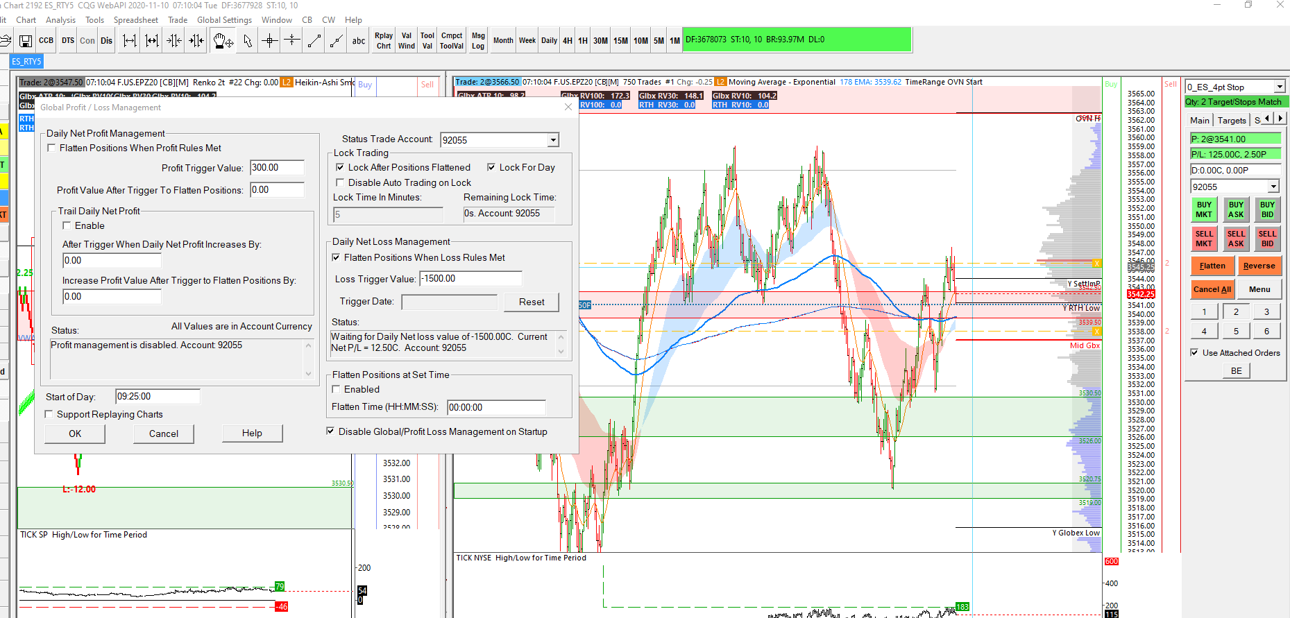

| AKR - Posts: 548 |
here u r did not save red marking. on right side you see open/running p&l in trade window to chart and left in global loss mngmt. its 1/10th Date Time Of Last Edit: 2020-11-10 12:15:27
| [2020-11-10 15:39:42] |
| John - SC Support - Posts: 48459 |

| [2020-11-10 18:58:35] |
We have looked through your chartbook and performed some simulated trades, but everything looks fine. All of the Currency Value per Tick settings look correct for the ES charts. You will have to do some testing on your end to determine if there is a particular chart that is causing this issue, or if this is just a summation of all the open trades. For the most reliable, advanced, and zero cost futures order routing, use the Teton service: Sierra Chart Teton Futures Order Routing |
