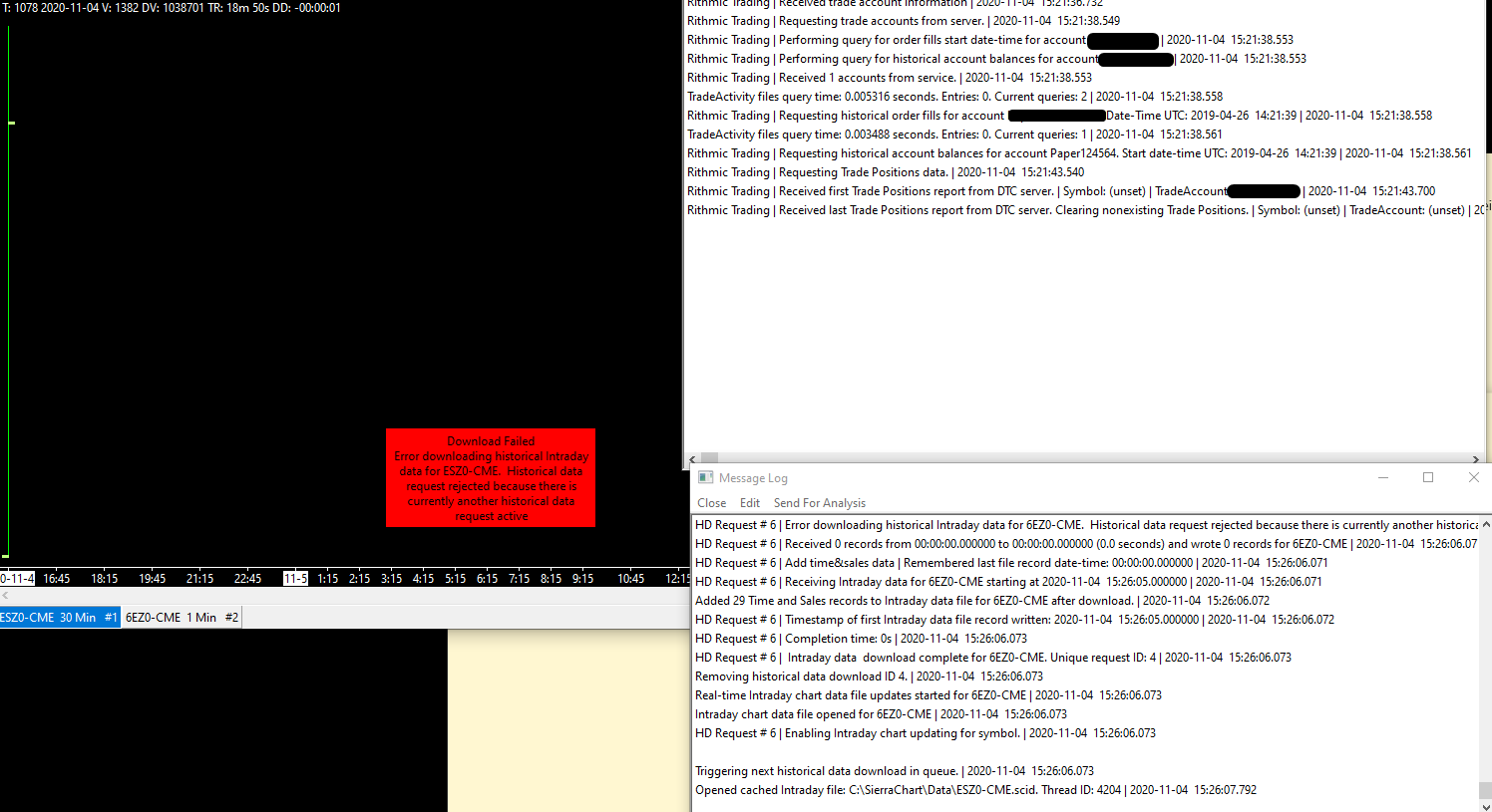

Hello, i started Sierra Chart, connected my Datafeed Rithmic and this is showing.
(See Picture)
Kind Regards
imageRithmic issuepng.png / V - Attached On 2020-11-04 14:35:33 UTC - Size: 81.48 KB - 285 views

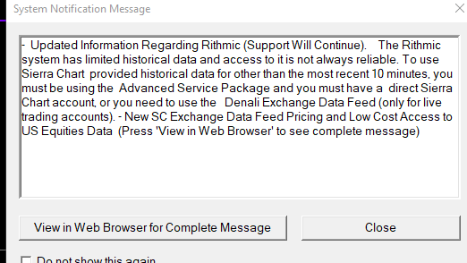

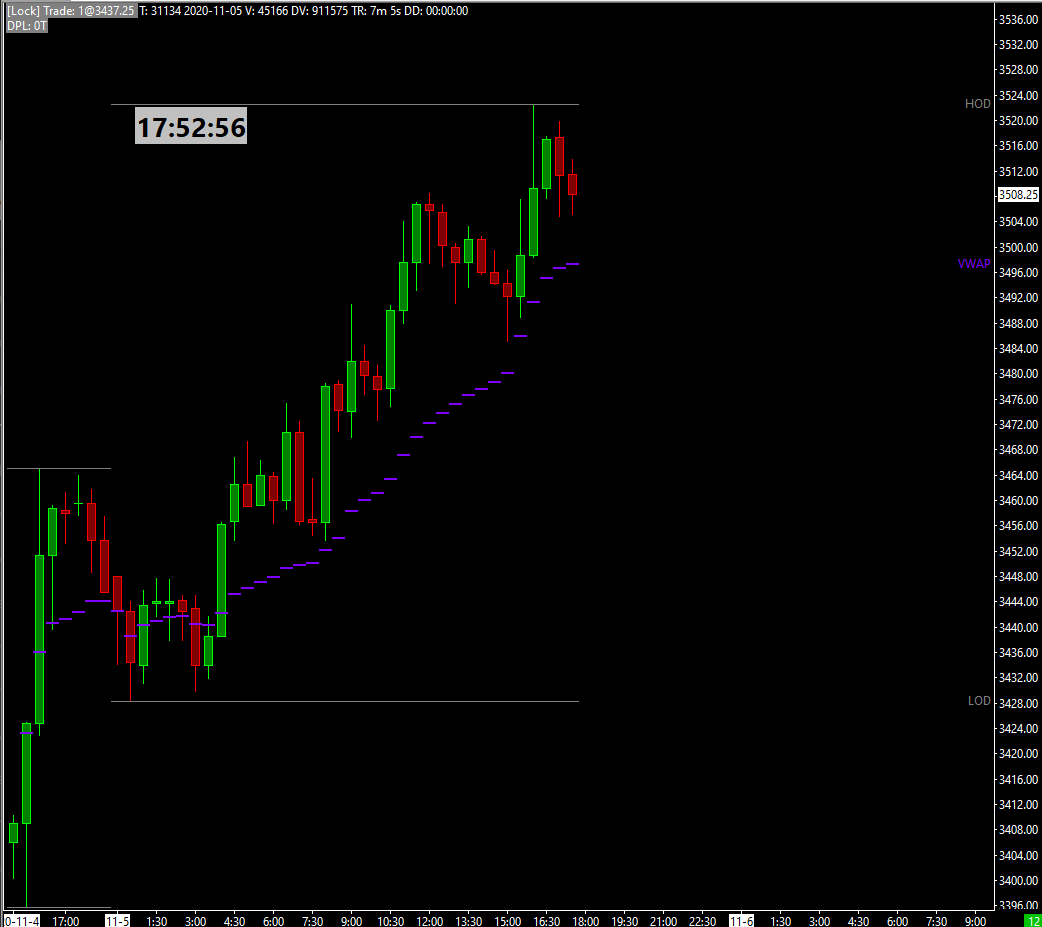

I used a direct account and purchased Package 5 because via AMP package 5 data didnt load. Now its also not loading only today. See picture. Regarding to AMP i should contact you.
imageScreenshot_ss1.png / V - Attached On 2020-11-05 16:53:22 UTC - Size: 42.03 KB - 346 views
imageRITHMIC+SC.png / V - Attached On 2020-11-05 16:53:27 UTC - Size: 16.83 KB - 315 views

[2020-11-05 22:24:09]
Jia T P R - Posts: 26
It sadly didnt helped but i reinstalled SC and then it worked.by the way im at AMP. When i use advanced Package Via AMP would Rithmic also work or does it need to be via own account?

You need to have a direct account when using Rithmic for the historical data support.
