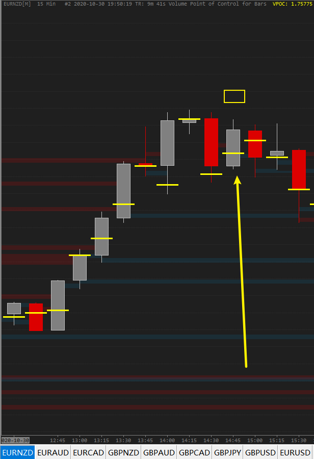

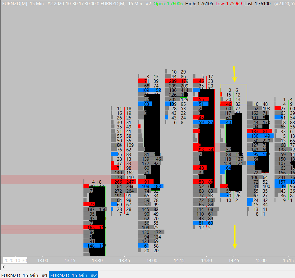

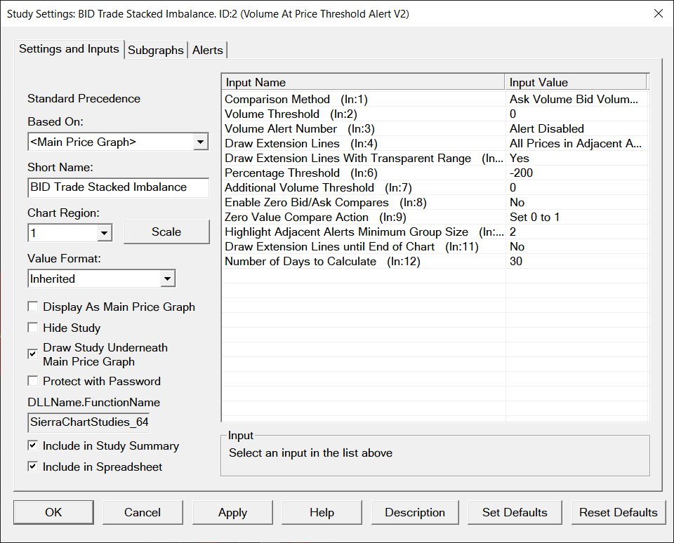

Volume At Price Threshold Alert V2 study,the parameter is same. But two chartbook, two result.a little difference.
imageparameter.png / V - Attached On 2020-10-30 11:58:57 UTC - Size: 52.54 KB - 461 views
imageorderflow.png / V - Attached On 2020-10-30 11:59:07 UTC - Size: 47.95 KB - 595 views
imagebar.png / V - Attached On 2020-10-30 11:59:15 UTC - Size: 15.39 KB - 447 views

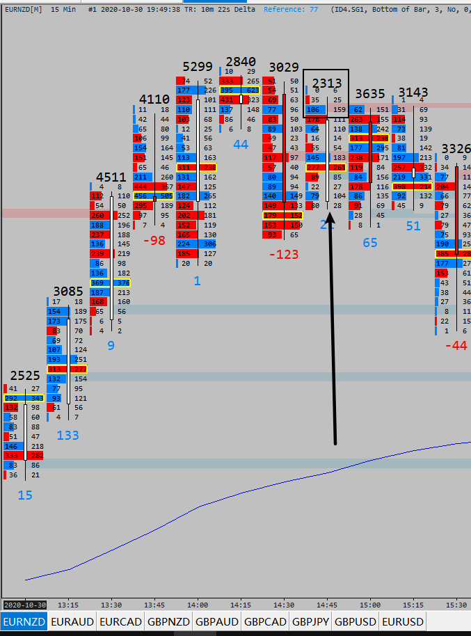

Why the same bar, the orderflow is not same.this orderflow is not equal to the orderflow.png.
imagebar-difference-orderflow.png / V - Attached On 2020-10-30 13:25:47 UTC - Size: 58.07 KB - 488 views

Those charts are set to different time zones, so you cannot compare the bars at the same time, as they are not the same bars. In order to be able to compare the charts, you would need to ensure that the time zones are the same (or you can mentally calculate the difference and look at the appropriate bars at the different times). Refer to the information here:

SC support is where ? Can you help me ? I change time zone , but the same time, odrderflow is difference.
[2020-11-03 09:52:02]
User907968 - Posts: 885
Volume at Price Multiplier - Chart Settings: Volume at Price Multiplier for Historical/Intraday Chart (Chart >> Chart Settings >> Chart Data >> Volume at Price menu)
[2020-11-03 09:59:38]
User509345 - Posts: 44
Thanks. It is same now. Best wishes to you.
