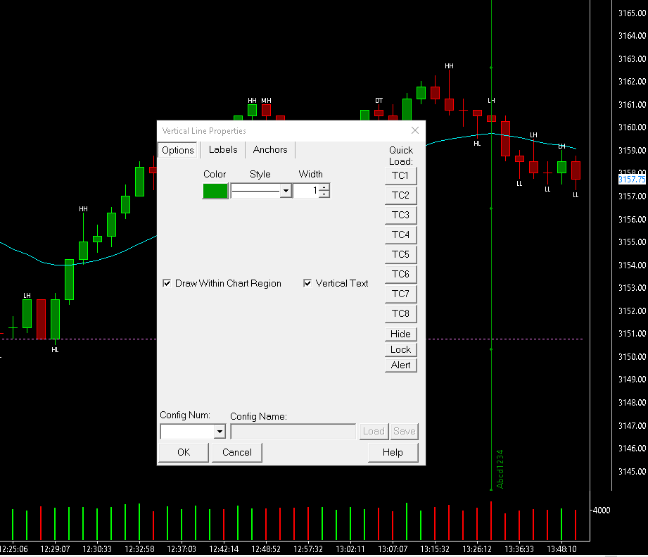

User300921 - Posts: 7
Note: what's REALLY annoying is that functionality is actually IS THERE - comes with Vertical Line [screenshot attached], but it only comes together with Vertical Line object {and I've tried to make it transparent - to leave just text) - nope, very limited settings for the Vertical Line object :((
I was asking basically the same ([Feature Request (?) / Programming Help (?) ] Text Tool: vertical text orientation), "[Programming Help] - [Feature Request (?) / Programming Help (?) ] Text Tool: vertical text orientation" - but nothing so far :((
imagesc=VertLine+VertText=OnlyTogether.png / V - Attached On 2020-12-02 14:29:24 UTC - Size: 33.04 KB - 430 views
[2020-12-02 18:51:41]
Ackin - Posts: 1866
Yes you are right .... It would also save space and be clearer in the chart window in some situations.
