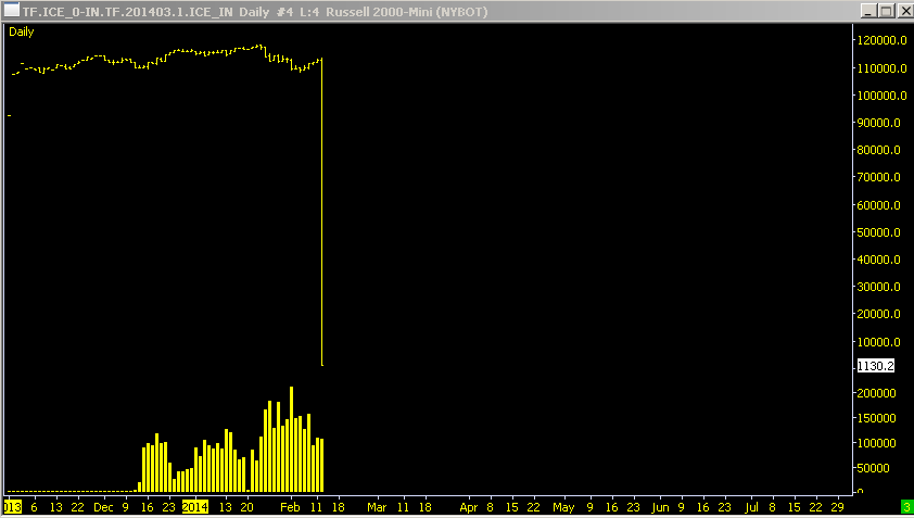

Update: historical daily charts now have glitch where last price comes in at e.g. 11270.0 however OHLC for previous day is in form of 112700 resulting in the current daily bar being some 100,000 ticks from H to L.

[2014-02-12 21:32:47]
T44 - Posts: 363
Updating the symbol settings has not resolved the issue.
Here is a screenshot.
image2014XSierraGlitch.png / V - Attached On 2014-02-12 21:32:33 UTC - Size: 8.12 KB - 610 views
[2014-02-12 22:19:14]
And did you Apply the Symbol Settings to the chart after updating them? We are quite sure the settings are correct.

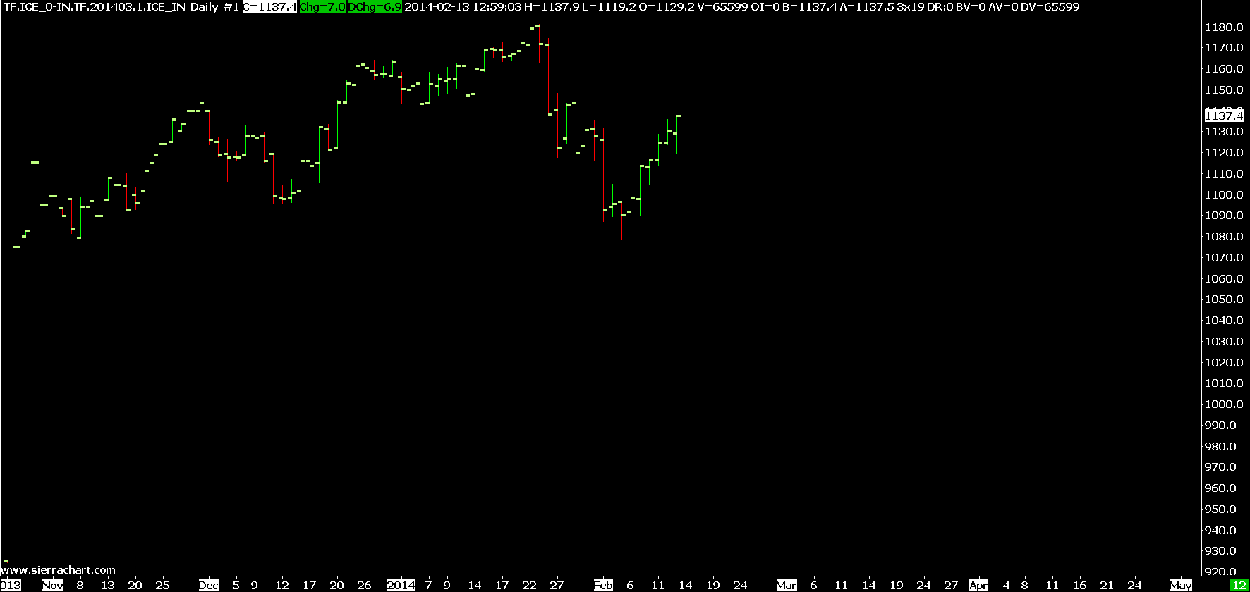

[2014-02-13 17:59:57]
What happens when you open a new chart through File >> Find Symbol?
We opened the chart for that symbol on the CTS live server in this is what we got:
http://www.sierrachart.com/image.php?l=1392314348272.png
It looks correct.
