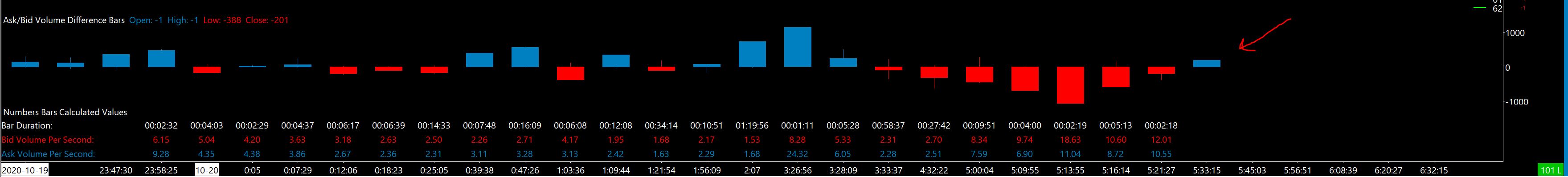

2) Got this extra bar that showed up on the Ask/Bid vol difference bar study - image attached

[2020-10-20 14:03:27]
2. That is the Pullback Column. Just set the Input for Include Pullback Column on the Ask/Bid Difference Bar study to No. Refer to the documentation here:

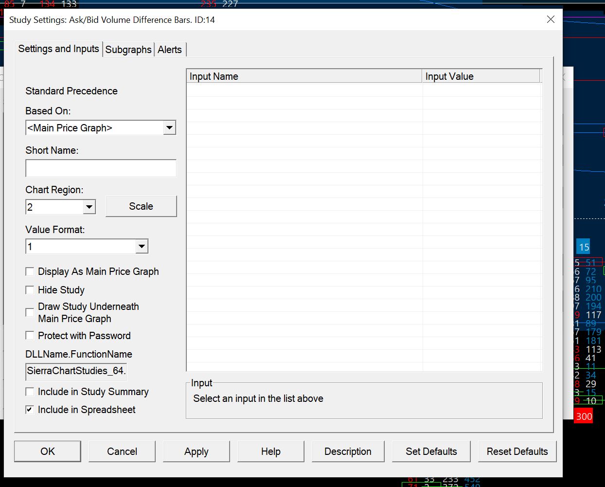

[2020-10-20 14:18:29]
Mistic - Posts: 76
I'm using v2179 and I have no inputs for that column. look at attached image
imageAB2.JPG / V - Attached On 2020-10-20 14:17:13 UTC - Size: 142.98 KB - 431 views
[2020-10-20 14:31:34]
Upgrade to the latest release to have the option to turn that column off.
