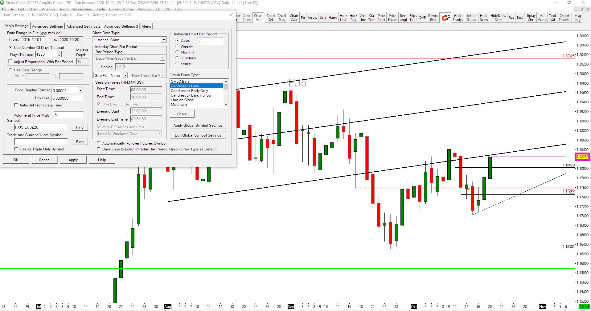

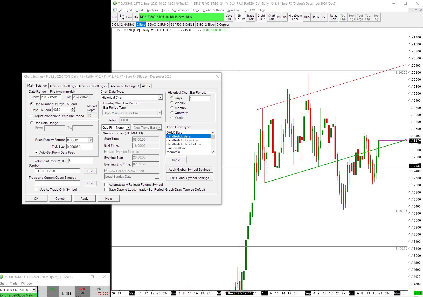

I am using 2 instances on eur6z20 contract.
I am attaching screenshots of the chart settings for each one.
The issue is that in each instance there is a difference between levels and where the market is at. In 1, the market is approaching an uptrend from the downside.
In the other, it has broken above. I have triple checked the trend anchor points and they are both the same in each chart, yet the lines trend in different l0ocations with regards to current at market prices.
Can you explain this please as it would be a huge problem to not know what is causing this issue.
Best
Tim
attachmentEUR 1.jpeg - Attached On 2020-10-20 11:13:24 UTC - Size: 212.36 KB - 377 views
attachmenteur 2b.jpeg - Attached On 2020-10-20 11:13:33 UTC - Size: 225.17 KB - 316 views

'EUR 1.jpeg' is continuous contract - volume based rollover [CV]
'eur 2b.jpeg' is continuous contract - volume based rollover, back adjusted [CBV]
Back adjustment causes the difference between the charts.

User907968 - Posts: 887
both charts are VOLUME BASED ROLLOVER BACK ADJUSTED
Are you sure, as your images do not reflect that?
'EUR 1.jpeg' has symbol F.US.EU6Z20 [CV]
'eur 2b.jpeg' has symbol F.US.EU6Z20 [CBV]
