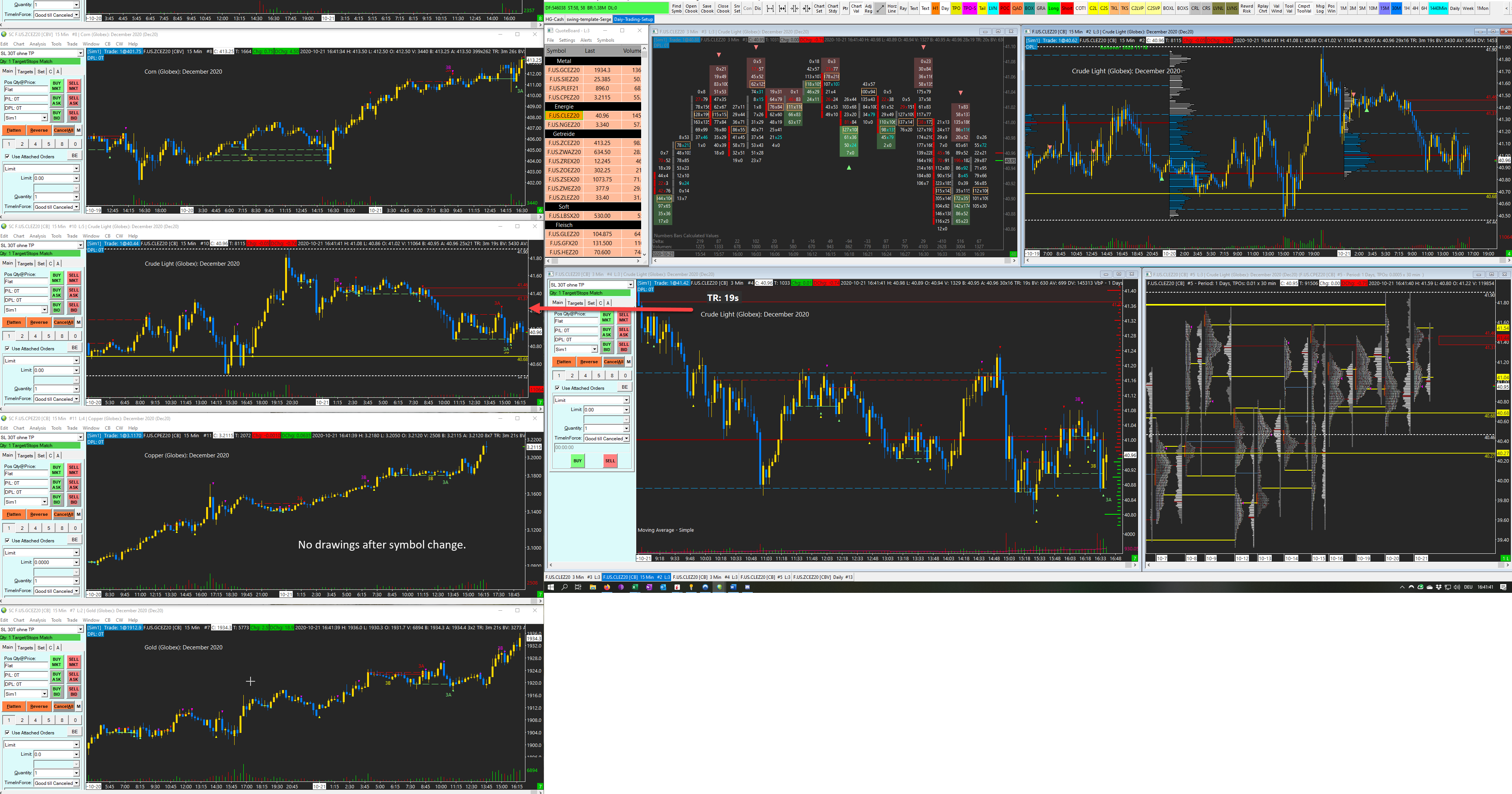

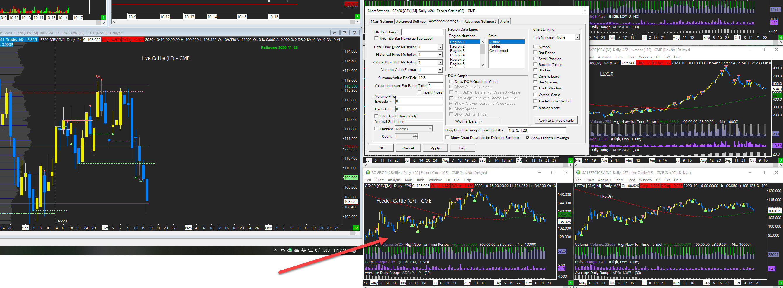

I have a problem with – copy chart drawings from chart#- since the update 2182.
I draw my lines in the main windows, and on my other monitors, I have each market in separate chart windows.
If I change the symbol (QuoteBoard) on the main window, all my drawings disappear on my separated chart. If I go back to the same symbol, the chart drawings are back.
Could you tell me how I could fix that issue?
Thank you for your effort.
imageGF-Pic.1.png / V - Attached On 2020-10-19 18:45:47 UTC - Size: 212.84 KB - 382 views
imageGF-Pic.2.png / V - Attached On 2020-10-19 18:45:57 UTC - Size: 222.96 KB - 304 views

Make sure the option for Show Chart Drawings for Different Symbols is Enabled. Refer to the information here:
Chart Settings: Show Chart Drawings For Different Symbols (Chart >> Chart Settings >> Chart Drawings menu)

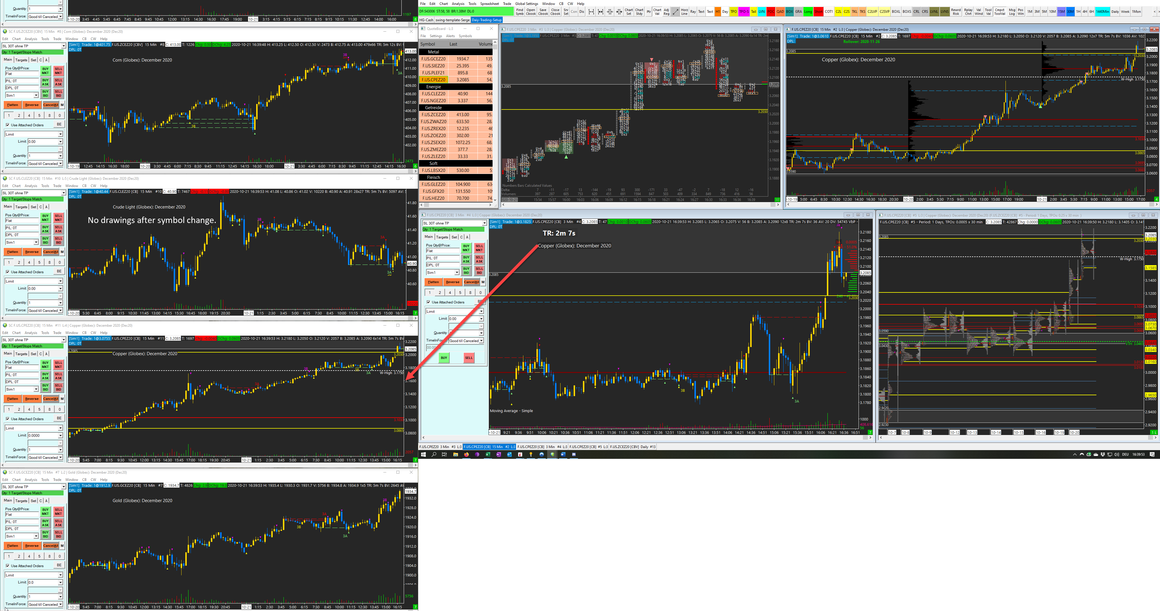

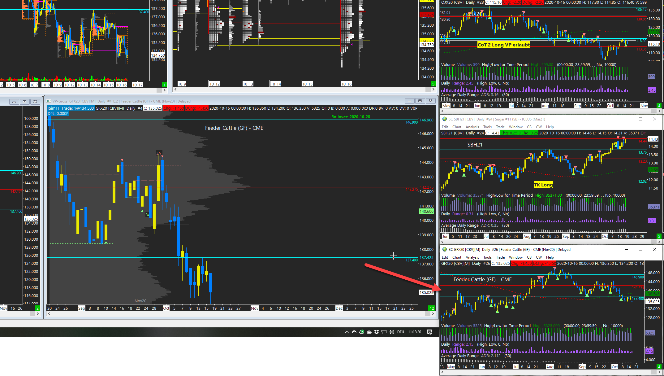

thank you for your feedback. Your suggestion doesn’t solve the issue. If if I work with drawings from different symbols, I get all drawings for all symbols I don’t need.
Bevor, I made the update all worked fin without problems to copy drawings from different charts for the same symbols. I checked the chart settings description on your pate again and again but without any success. I could not understand why, after the update 5152 and higher, this function is not working.
Thank you in advance for your effort.
image1.png / V - Attached On 2020-10-21 16:13:19 UTC - Size: 659.35 KB - 310 views
image2.png / V - Attached On 2020-10-21 16:13:30 UTC - Size: 605.62 KB - 353 views
