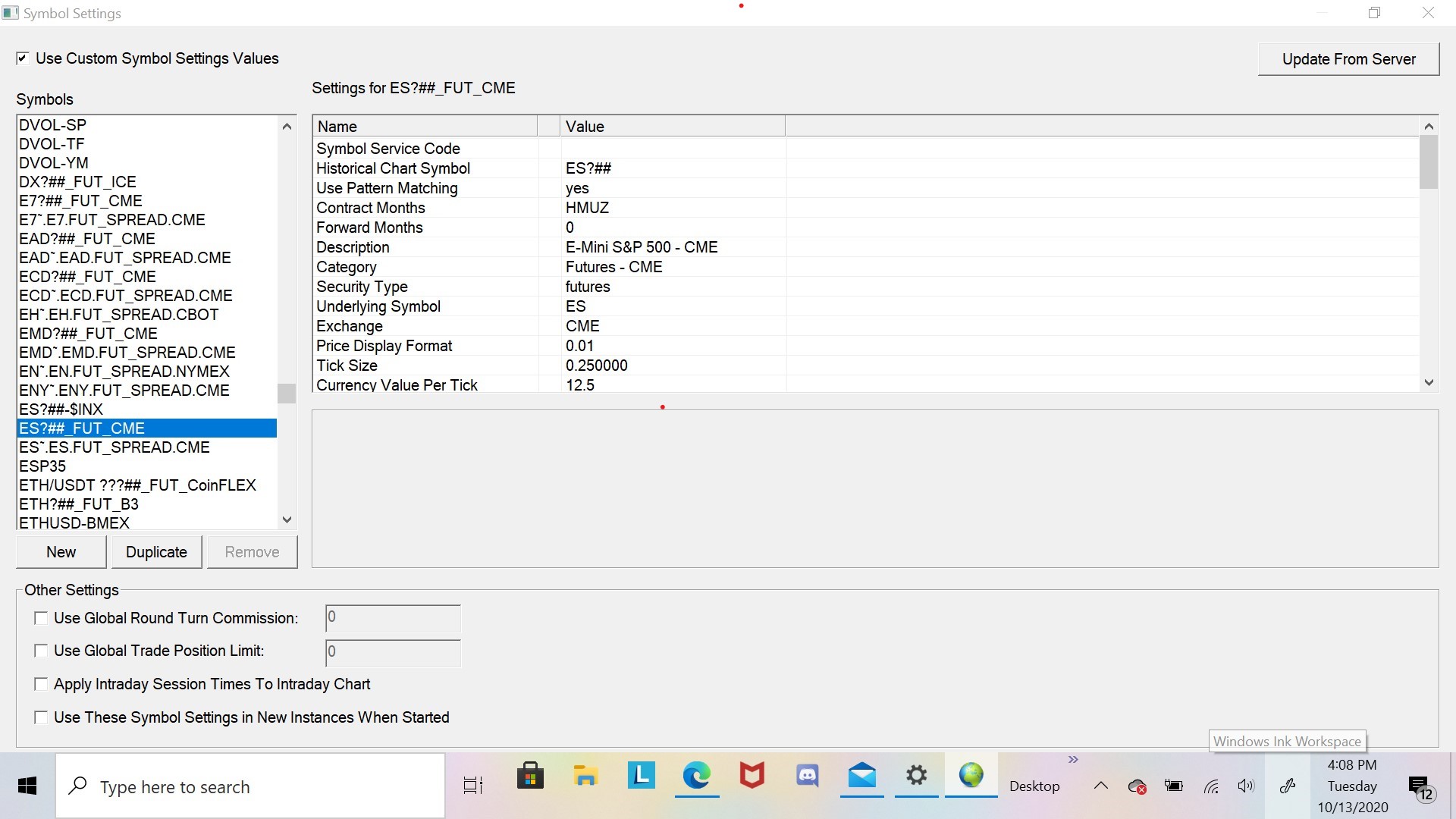

I am trying to set up Replay feature on my Sierra.
However when I do through that there supposed to be a button to click OK.
Unfortunately it looks like it is "stuck" somewhere down.
any advice?
Thank you;
Andrew
imageReplay Feature.jpg / V - Attached On 2020-10-13 14:18:08 UTC - Size: 271.58 KB - 305 views

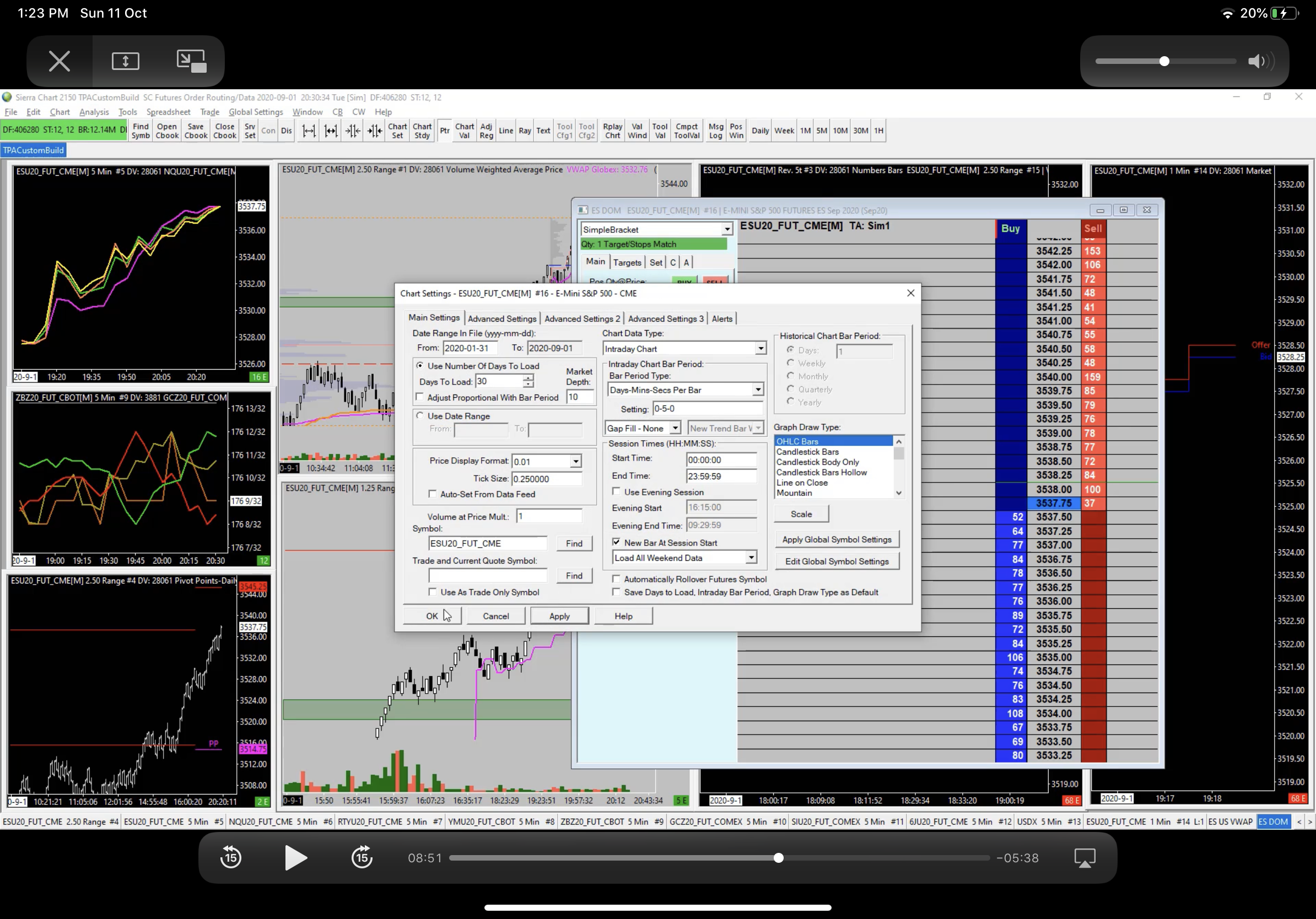

imageReplay feature 2.PNG / V - Attached On 2020-10-13 14:20:18 UTC - Size: 4.86 MB - 444 views
[2020-10-13 16:13:13]
With regards to the Symbol Settings page, the OK and Cancel are hidden behind the Task Bar at the bottom. But it looks like the window is maximized, so you should be able to just un-maximize it and then be able to get to the OK and Cancel buttons. You can also click the X in the upper right to close it, and then when you open it again, it should be its normal size.
We are not sure what you are trying to show with the other image.

[2020-10-13 20:56:51]
We are going to be re-implementing the Symbol Settings window which will solve the problem of not being able to access the buttons at the bottom. For now move your Windows taskbar to the left or right side of your screen or hide it.
Allow about one month for this to be done.
