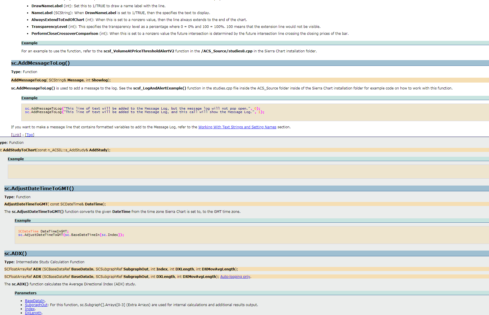

btw There is some problem with the site with this requested feature description showing a strange background. Like when someone forgot to write a TAG in the source code of the page.
ACSIL Interface Members - Functions
imageweb issue.png / V - Attached On 2020-10-10 18:39:31 UTC - Size: 82.3 KB - 383 views
