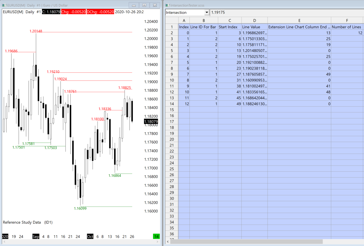

[2020-10-26 20:41:05]
User253985 - Posts: 24
The code below gives the output as per the attached picture 'Line until Intersection.PNG'
when it is recalculated it gives the output of 'Line until Intersection 2.PNG'
It doesn't replace upon recalculation it adds to the variable.
The Actual Number of Lines Until future Intersection is not increasing.

Date Time Of Last Edit: 2020-10-26 20:43:02
imageLines until Intersection.PNG / V - Attached On 2020-10-26 20:23:46 UTC - Size: 182.33 KB - 497 views
imageLines until Intersection 2.PNG / V - Attached On 2020-10-26 20:26:27 UTC - Size: 211.86 KB - 501 views
