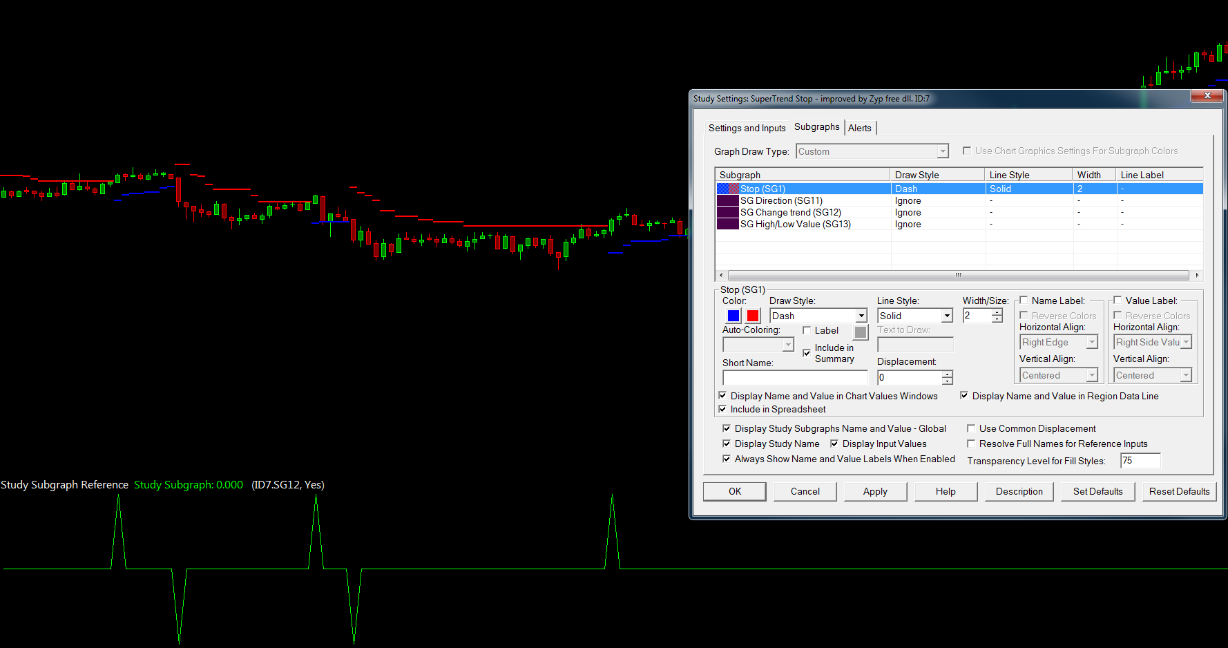

I've made this as an improvement in the past. If you want, register on the forum czsk and download it as a study there (without source code)
Study:SuperTrendStop - improved
contact link:
imagesupertrend improved.png / V - Attached On 2020-10-06 16:52:38 UTC - Size: 80.34 KB - 576 views
