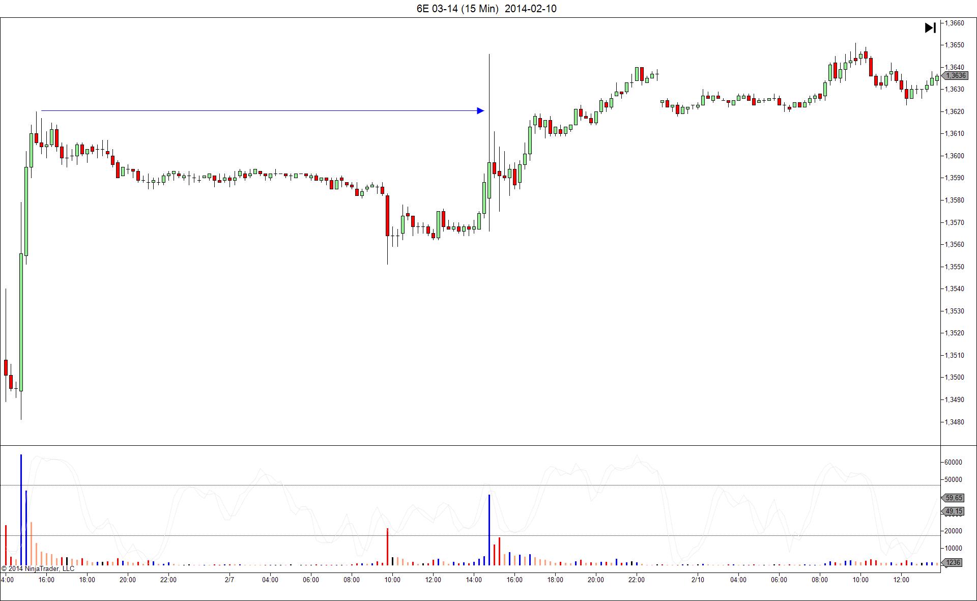

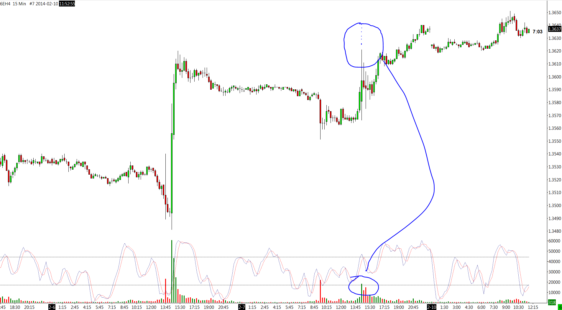

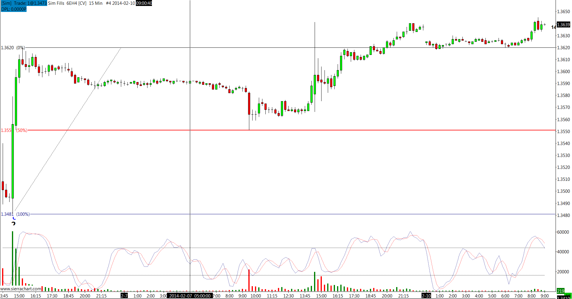

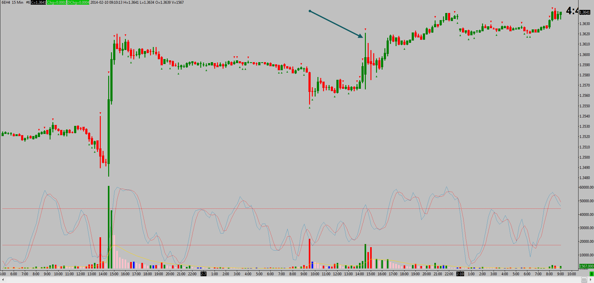

My broker is Infinityfutures and I use sierrachart platform.
Version sierrachart 1090
every time I deletes and uploading data I receives a different chart and volume
How is it possible ?
all my friends have the same
Screenshot attached
Date Time Of Last Edit: 2014-02-10 09:03:47
image6EH4 [CV] 15 Min #4 41680.333.png / V - Attached On 2014-02-10 08:41:44 UTC - Size: 64.54 KB - 622 views
image6EH4 [CV] 15 Min #4 41680.334.png / V - Attached On 2014-02-10 08:41:49 UTC - Size: 62.44 KB - 645 views
image6E 03-14 (15 Min) 2014-02-10.jpg / V - Attached On 2014-02-10 08:43:11 UTC - Size: 160.06 KB - 619 views
imagesierrachart.jpg / V - Attached On 2014-02-10 08:47:06 UTC - Size: 212.74 KB - 697 views
imagesierrachart2.jpg / V - Attached On 2014-02-10 08:47:12 UTC - Size: 227.72 KB - 644 views

There are too many images posted without a clear explanation of exactly what the problem is. It is best to post one or two images and point out clearly what the problem is. Anyway, we think we have figured it out. There is missing data. The TransAct data feed had an interruption for a few minutes around the time in question.

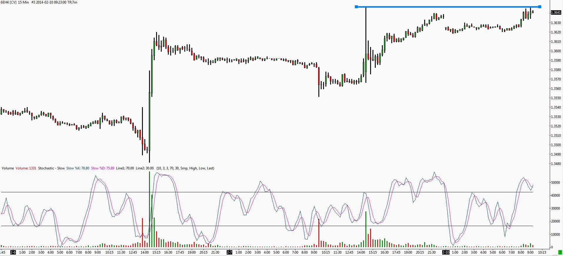

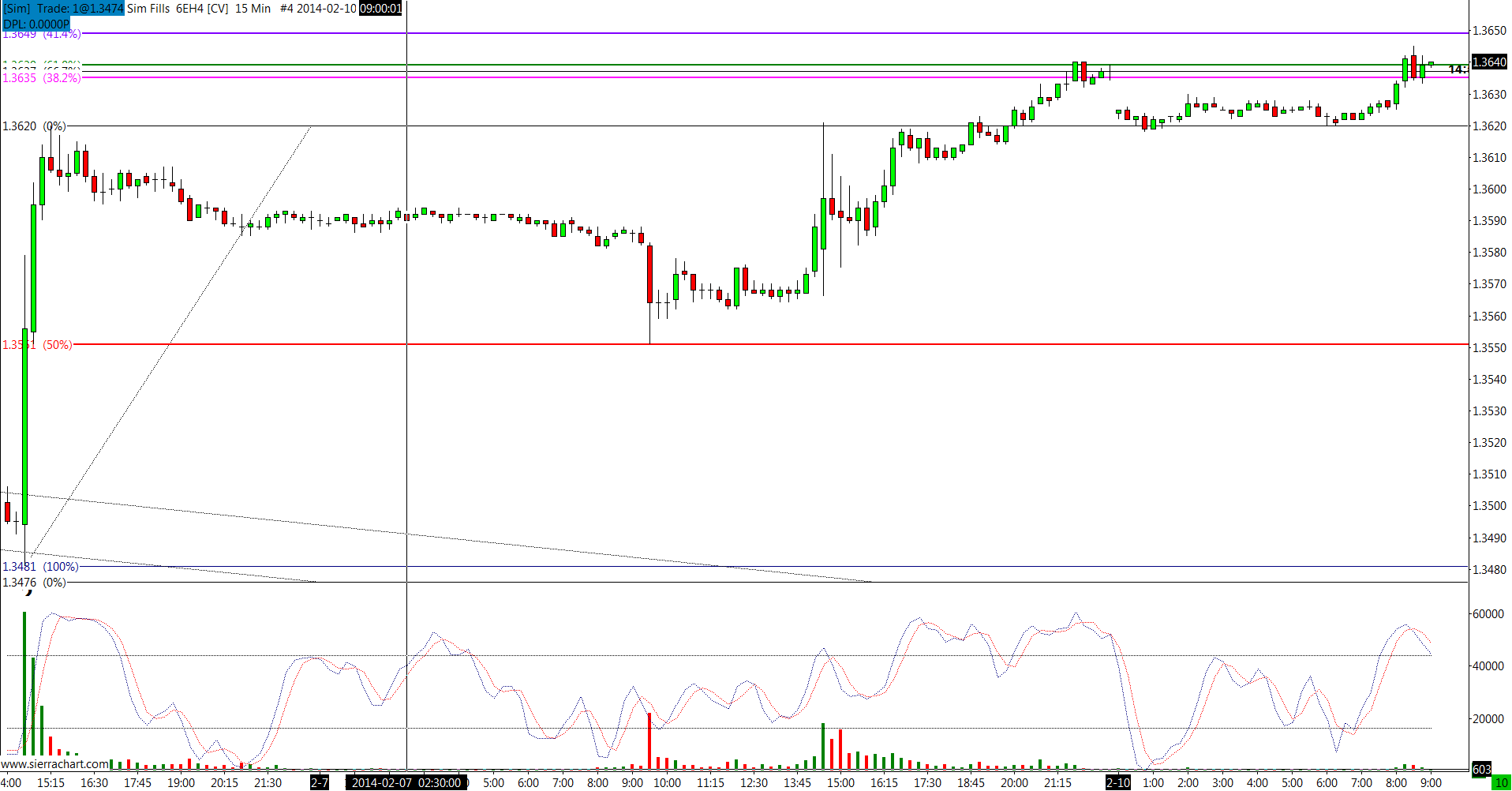

[2014-02-10 11:02:51]
User98871 - Posts: 3
This is the chart that I did two minutes ago after deleting and uploading data
I marked differences
Very often happens that I and my colleagues have other values ​​in the volume.
Date Time Of Last Edit: 2014-02-10 11:03:18
imagemissing data.PNG / V - Attached On 2014-02-10 10:55:14 UTC - Size: 79.19 KB - 653 views
[2014-02-10 16:57:31]
We are going to need to patch the missing data. This will be done at the end of the day to resolve this.

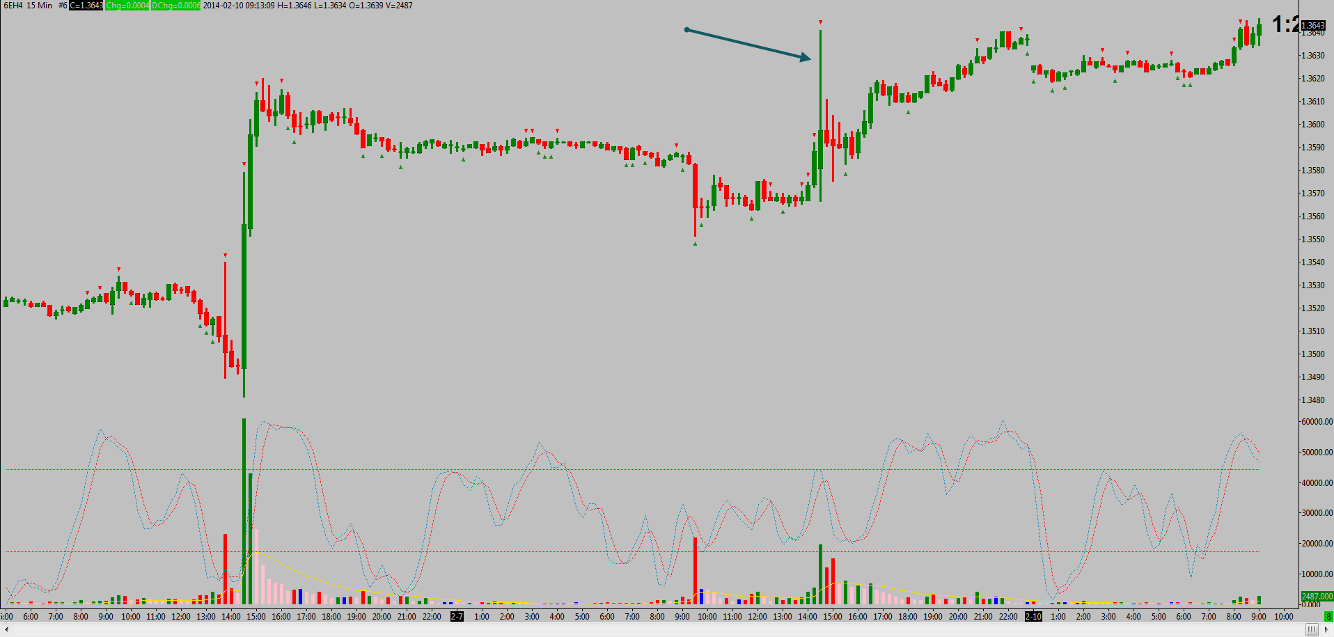

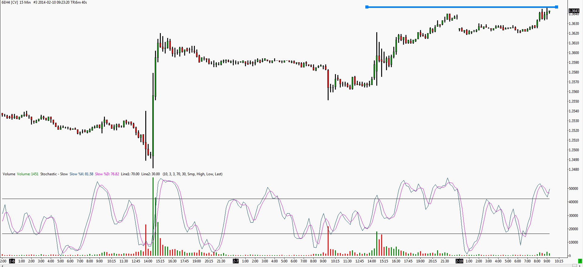

Thank you for trying to repair the data, but it still does not work.
Below please find two charts from two different platforms
Please compare and see the difference.
The difference in the appearance of candles and the difference in volume.
Very often it happens that I and colleagues who use the same platform "Sierrachart" we have different values ​​of the volume.
several times downloading and deleting data does not help
image6EH4 [CV] 15 Min #4 41682.358.png / V - Attached On 2014-02-12 09:40:49 UTC - Size: 66.02 KB - 654 views
imagenINJATRADER.jpg / V - Attached On 2014-02-12 09:41:03 UTC - Size: 141.19 KB - 707 views
[2014-02-12 10:11:00]
We work on this again at the close of the day. We did not reload data back into Friday February 7.
Also, Sierra Chart is not the provider of the data feed you are using. It is provided by TransAct Futures.
Date Time Of Last Edit: 2014-02-12 10:11:30
[2014-02-12 10:54:02]
We have corrected the data for 6EH4 going back into Friday. Since the improved method of patching, we were able to do this quickly right now.

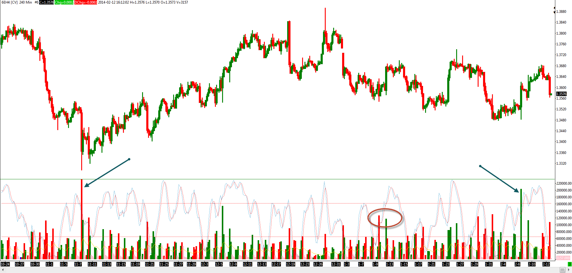

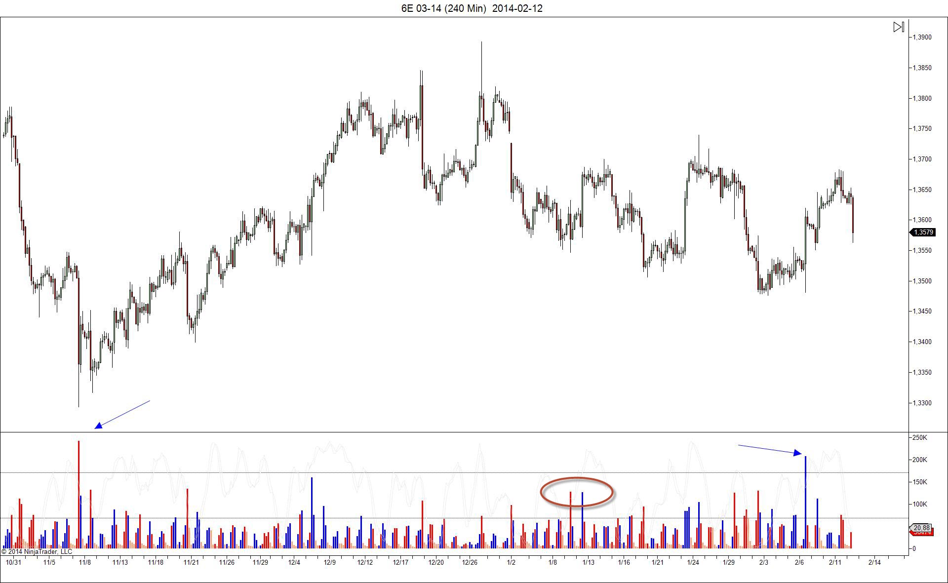

User76837 - Posts: 7
Can You check this two highest volume spikes on attached files? Same data, same platform (Infinity) but on two different machines (see first and second screen)and as You can notice on one screen that red spike is higher and on another the highest is that green spike (I mardek differenc by arrows).
I attached also screen from ninja platform where volume is similar to second picture from ninja but there is also one diffrence which I marked it by circle.
Kind Regards
Lukasz
Date Time Of Last Edit: 2014-02-12 15:48:08
image6EH4 [CV] 240 Min #8 41682.58.png / V - Attached On 2014-02-12 15:43:15 UTC - Size: 43.85 KB - 672 views
image2014-02-12 16-12-04.png / V - Attached On 2014-02-12 15:44:22 UTC - Size: 83.91 KB - 574 views
image6E 03-14 (240 Min) 2014-02-12.jpg / V - Attached On 2014-02-12 15:44:32 UTC - Size: 217.53 KB - 581 views
[2014-02-12 18:14:35]
The Sierra Chart is not the provider the data feed and is not able to resolve these issues. We will let TransAct know about them. We cannot be reloading the historical data from an alternate source every day.
