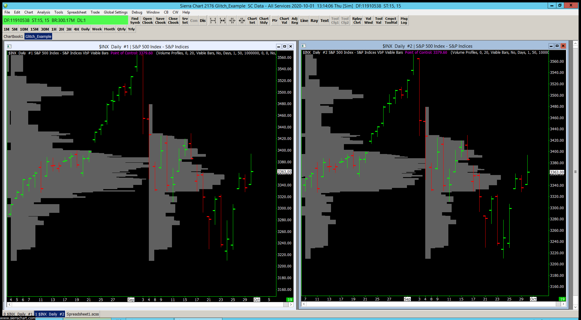

The VbP print is totally wrong for the latest bar. I also have problem with my custom studies using sc.VolumeAtPriceForBars
I attach a chart example. Please take a look, thank you.
Date Time Of Last Edit: 2020-10-01 04:33:08
attachmentGlitch_Example.Cht - Attached On 2020-10-01 04:27:43 UTC - Size: 3.77 KB - 504 views
[2020-10-01 18:16:24]
We do not see any problem when we open your chart. We copied the chart and changed the Volume Multiplier to 1 and then compared the two charts and they look identical. The following link is what we see:
http://www.sierrachart.com/image.php?Image=1601576053826.png
If you can take an image of what you are seeing, then that will help us.

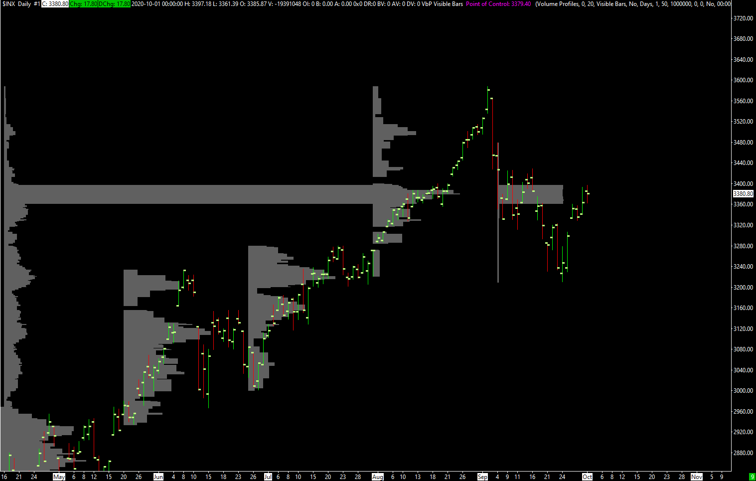

[2020-10-02 01:30:56]
User353585 - Posts: 69
http://www.sierrachart.com/image.php?Image=160160214716.png
This is what I see. I took the screenshot on the fresh new installation.
FYI, sometimes there is no problem (right now, for example). so it might have something to do with the time of day.
