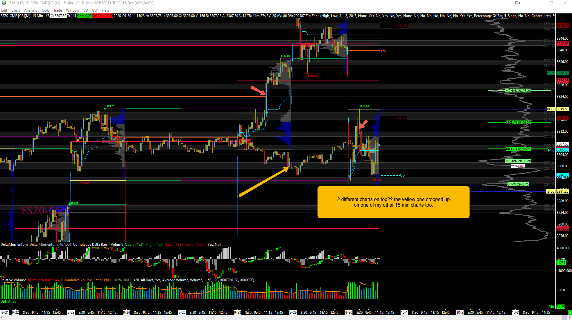

I was working on one of my charts ( 4t renko ) , and on 2 other charts (15 mins) suddenly an unidentified chart cropped up?
it is overlayed, i cant tell what it is.
I was prior working on overlaying a study on 2 unrelated charts ( in same chartbook ).

image2 diffrent charts on top.png / V - Attached On 2020-09-30 10:20:25 UTC - Size: 126.88 KB - 325 views
[2020-09-30 10:47:02]
User97684 - Posts: 136
..i can see now it is overlaying my 4T renko chart on top of all my 15 min charts
[2020-09-30 15:32:32]
You must have a Study/Price Overlay study on that chart that is causing this. So just take a look at your studies and remove the one that should not be there.
It's also possible that you have the charts linked for Studies, so when you added the Study/Price Overlay on one chart, it was added to the other ones as well. Refer to the information here on Chart Linking:
https://www.sierrachart.com/index.php?page=doc/ChartSettings.html#LinkNumber
