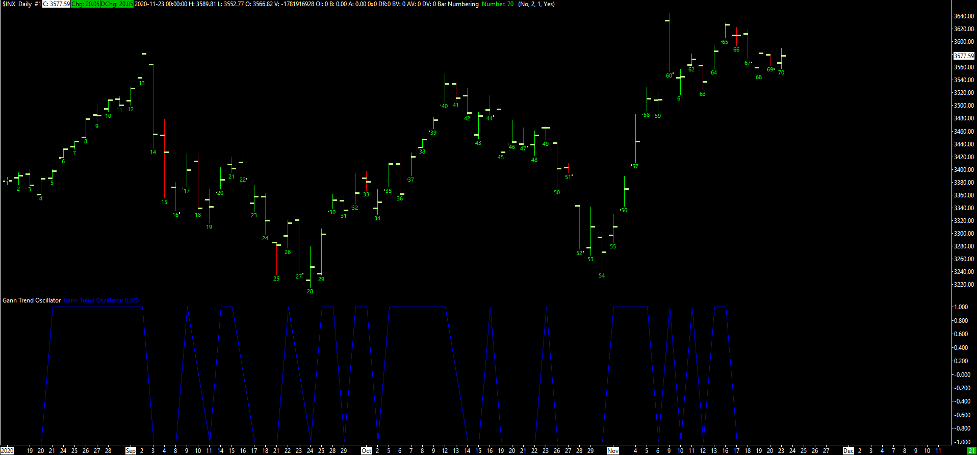

Here is the Gann Trend Oscillator (GTO) as I understand it.
* I defined an Uptrend as 2 or more bars in which the High and Low are both increasing, in which case GTO = 1.
* I defined a Downtrend as 2 or more bars in which the High and Low are both decreasing, in which case GTO = -1.
* In any other case, GTO = 0.
I have attached both the code and a screenshot of the results. Please let me know if this study is what you expected.
I am still ironing out some bugs in the Gann Swing Oscillator.
attachmentscsf_GannTrendOscillator.cpp - Attached On 2020-11-24 11:32:56 UTC - Size: 1.1 KB - 688 views
image$INX Daily #1 2020-11-24 03_51_22.367.png / V - Attached On 2020-11-24 11:33:12 UTC - Size: 40.18 KB - 581 views

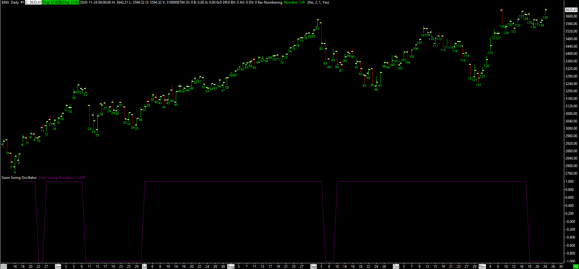

Here is the Gann Swing Oscillator (GSO) as I understand it.
* I set GSO = 0 for the first 2 bars.
* I check for an Upswing followed by 2 higher Highs, and if this happens I set GSO = 1.
* I check for a Downswing followed by 2 lower Lows, and if this happens I set GSO = -1.
* If neither of the previous two conditions is satisfied, then I set GSO = GSO[1].
I have attached both the code and a screenshot of the results. Please let me know if this study performs as you expect.
I will submit both GSO and GTO (previous post) to Sierra Chart Engineering as soon as I have confirmation that the algorithms are correct.
attachmentscsf_GannSwingOscillator.cpp - Attached On 2020-11-25 22:23:00 UTC - Size: 2.68 KB - 747 views
image$INX Daily #1 2020-11-25 16_18_53.119.png / V - Attached On 2020-11-25 22:23:14 UTC - Size: 43.86 KB - 555 views
