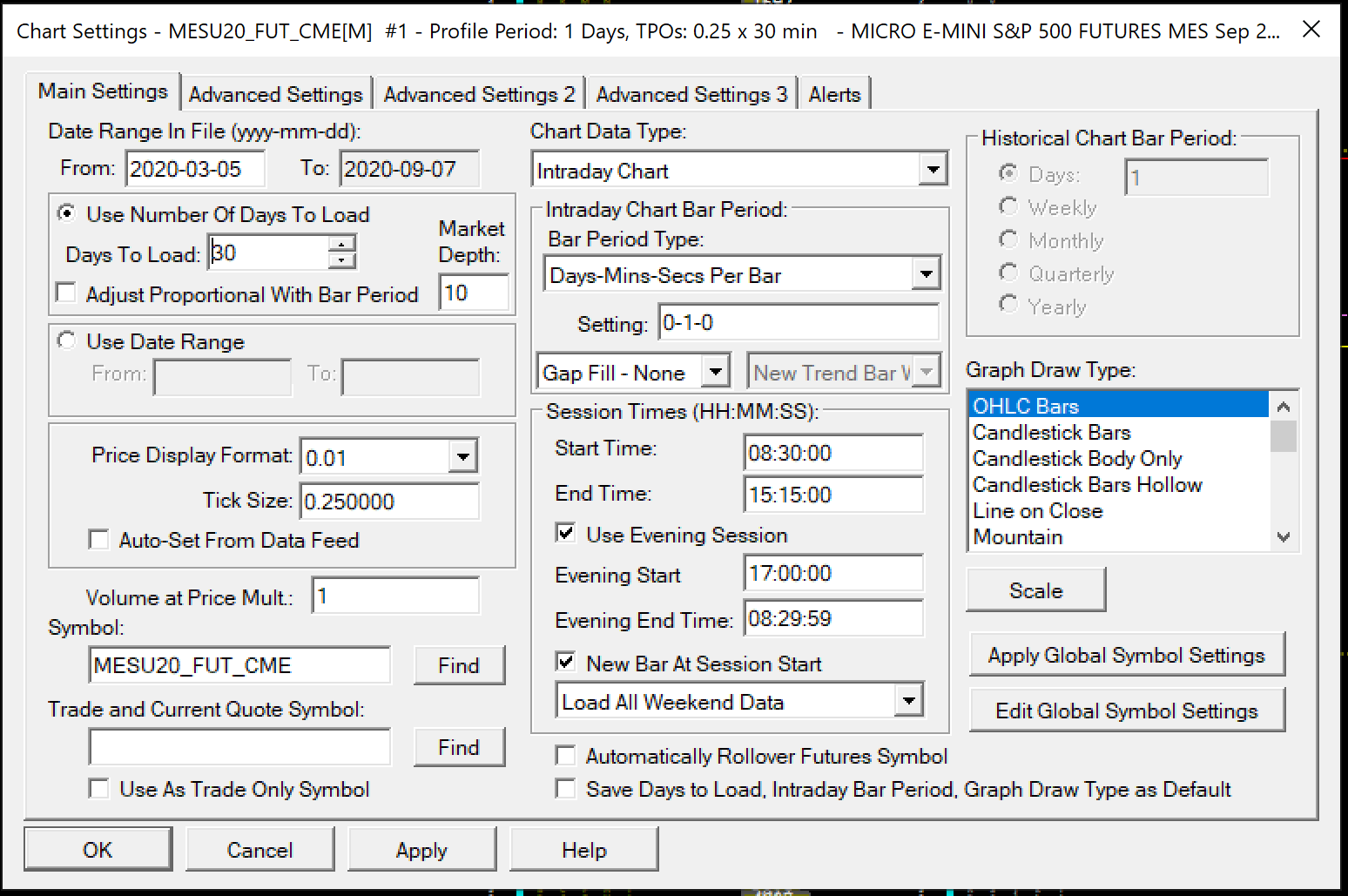

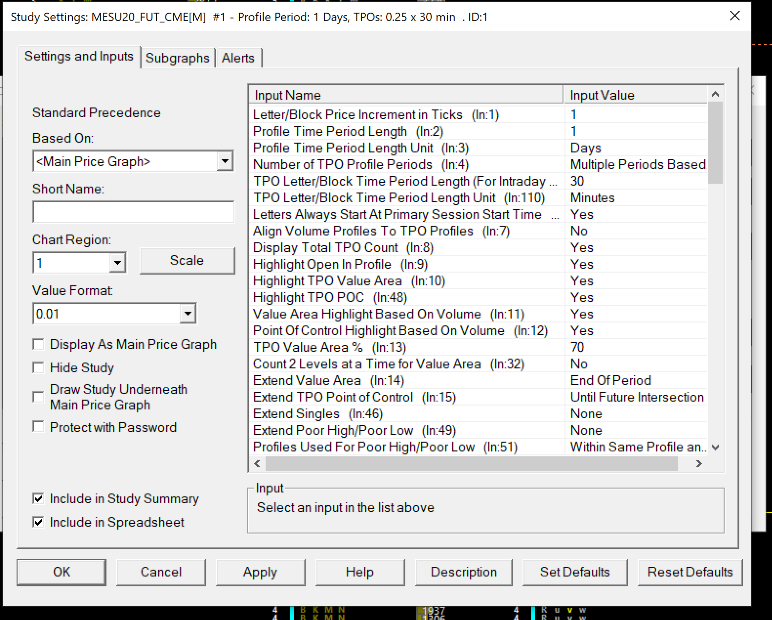

The following problem seems to happen at random. There are several days where value area highs, lows, pocs, are not being calculated correctly and it throws off the entire day of trading.
As an example, consider the disparity between 9/3 and 9/4 sessions. The value area calculation based off of the attached settings should yield a value area high of around 3453 and value area low of 3382, a poc volume of 3430 and poc time at 3400.50 for the 9/4 session. My screen shows VAH at 3429 and 3349 as the respective areas, 3372 as Volume POC and and Time POC. While 9/3 has the correct value areas.
Ive started and stopped sierra multiple times but this seems to be happening on different computers. I can only guess that there's an issue perhaps with the Denali/TT feed that's coming through. I am also including my VBP settings and TPO Setting along with datafeed settings.

We are not seeing any issues with your charts. The Value Areas for each TPO matches to that of the VbP for the same period.
The Point of Control is going to be different between the TPO and the VbP because of how each of these is calculated. Refer to the information here:
Time Price Opportunity (TPO) Profile Charts: How Point of Control and Value Area Are Calculated
Additionally, looking at the data for 9/4, the POC for the VbP is correctly placed at a price of 3372.00 as this has the highest volume for the day at 6181. We do not know where your stated numbers of a price at 3400.50 and a volume of 3372 comes from.

Chartbook1.cht and the images you originally provided were for the symbol MESU20. This last chartbook does not have that symbol in it (there are ESU20 symbols, but not MESU20).
Therefore there should be differences in the calculations, as these are two different symbols.
