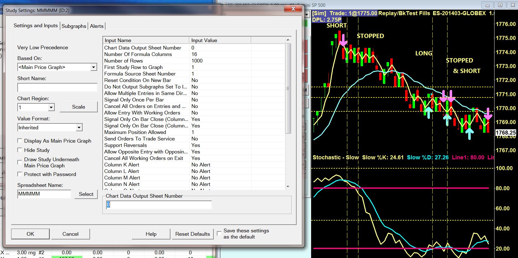

Trying to figure out setting stop on my sell exit came up with this but it is not accepted as a correct format.
=OR(AND($J$8>0,$E$3<=$J$91),AND(CROSSFROMABOVE(AH3:AH5,AJ3:AJ5))
instead of just =CROSSFROMABOVE(AH3:AH5,AJ3:AJ5)
When I attempted to use attached order stop order via the Trade Window, orders are all ignored because working orders exist.
Without attached order seems to work fine on replay backtest.

[2014-02-07 12:44:57]
Litz - Posts: 135
I got the attached order working thanks for the help.

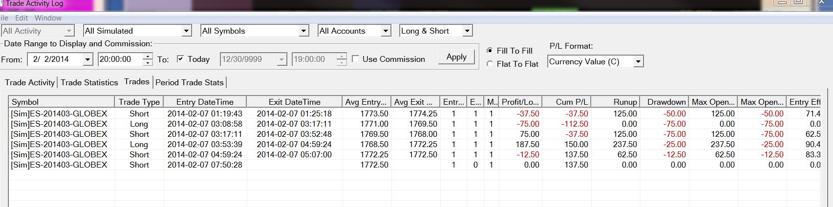

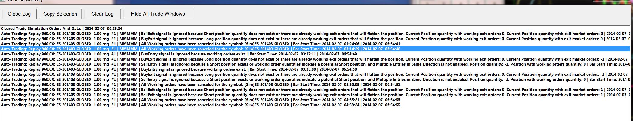

I have read the "Disappearing Arrows" documentation and am analyzing the problem of trades being 'true' and happening as per the positions and order, alert manager, and the trade activity manager.
A replay from this morning ES trades reveals my entries are good, but the trade is often cancelled and reversed due to the price crossing over the short term moving. See attached file for example. Spreadsheet setting included. I have no clue on how to prevent this from occurring. The trade service log just has ignores (attached.
Date Time Of Last Edit: 2014-02-07 12:55:50
