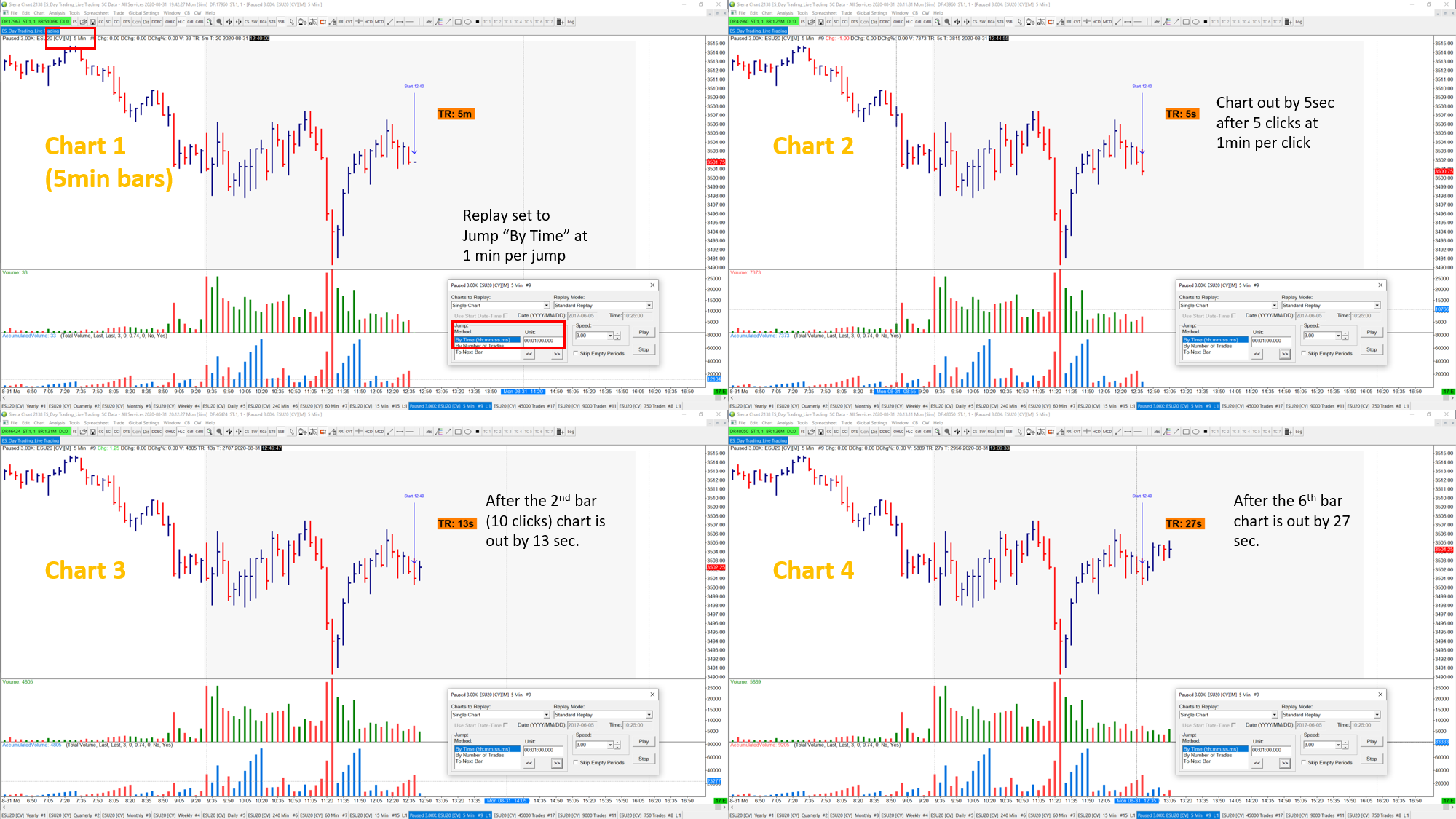

[2020-09-01 00:43:28]
User629461 - Posts: 213
What I'm trying to explain is that it doesn't jump by the specified time.
See attached series of charts. I'm using a 5min chart with 1min Jump period as shown in the Replay window. Chart 1 is the start and after the first 5min period (5 cicks) the chart is out by 5 sec (Chart 2). By the end of the second bar (Chart 3) the chart is out by 13sec. By the 6th bar (Chart 4) the chart is out by 27sec and so on. By the 13th bar (not shown) the chart is out by almost 1 minute.
imagePicture1.png / V - Attached On 2020-09-01 00:41:49 UTC - Size: 612.04 KB - 437 views
[2020-09-02 06:46:48]
We are not fully understanding this but we did identify one issue when jumping bar by bar based upon the old implementation of this functionality:
Replaying Charts: Stepping through Chart Bars One by One
The old implementation is no longer documented but the implementation in the program was there. But this would not apply in your case because the jump time does not match the timeframe of the chart bars.
