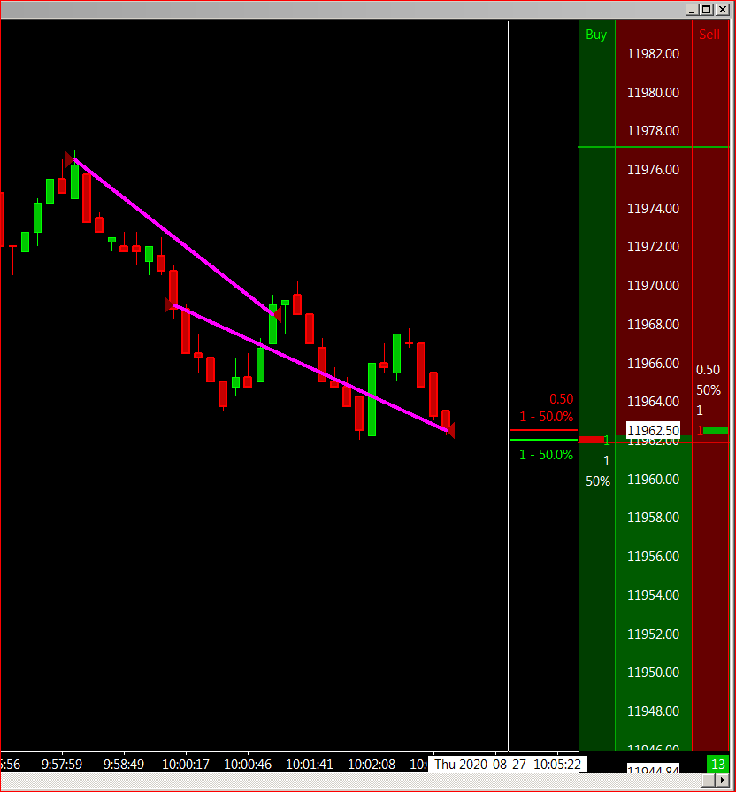

After I made my first entry and it is positive, and then make my second entry, and the associate break-even stop from the second entry gets hit, it takes out the first (still profitable) entry, not the second entry.
I tried several different setups, with fast in break even, trailing stops, but I keep getting the same errors. How can I make sure that if I make multiple entries, the associate breakeven, stop, and/or trailing stop, stays with its original entry.
What do I need to change? Any suggestions?
UPDATE! Watch the video below and see it yourself what I try to explain in a simple video.
I made some screen prints for those who do not like to watch video, in the attached zip file :-)
Date Time Of Last Edit: 2020-09-02 08:23:53
attachmentThe video in 5 pictures.zip - Attached On 2020-08-28 11:19:29 UTC - Size: 1.46 MB - 615 views

Okay I tried :Chart >> Chart Settings >> Advanced Settings 3 >> Use Last In First Out Fill Matching.
Apparently it does not work with an automatic stop to breakeven (+x) setting in your attached orders..
What a shame, even an simple MT4 could do this.. How can you ever scale in and out, and not have this simple feature working correctly.. (?) :-(

NQU20, 34 Trades, 2020-08-27, Brussels timezone
Sequence:
- in 9:58:07 bar, go short at 11976.50
- at its +10 ticks, its stop moves to its BE+2 at 11976.00, as expected.
- in 10:00:17 bar, go short again at 11968.50
- at its +10 ticks, its stop moves to its BE+2 at 11968.00, as expected.
- price retraces to 11968.00 and the second entry is stopped out, and its target is OCO'd.
- the first entry's stop and target remain.
- the only difference at this point is the FIFO/LIFO setting used for each sequence.
With the chart set to FIFO, the Position Average Price after the second entry stopped out is 11968.50
With the chart set to LIFO, the Position Average Price after the second entry stopped out is 11976.50 (the first entry's price).
Scale In and Scale Out are not checked
Date Time Of Last Edit: 2020-08-28 19:54:19

I took another look, and I see what you are saying: The DPL when the second entry stops out is $160/32 ticks, which is the first entry's winnings, not the second entry's 2 ticks winnings.
However, when the first entry hits its target, the DPL for both entries is the same as it would have been had the second entry been 2 ticks profit.
IOW:
- second entry makes +32 ticks
- first entry makes +26 more ticks
- total +58 ticks
If the second entry made +2 ticks, first entry would have made +56 ticks. Same total of +58 ticks.
Same profit, but since the chart was set to LIFO, the trade's connecting lines are confusing at best, inaccurate at worst. See attached.
Date Time Of Last Edit: 2020-08-28 21:01:53

The basic reason you cannot accomplish reliably what you want is that order fills are matched according to time and according to LIFO or FIFO matching. There simply is no association with the parent order and child order relationship.
It is completely unpredictable as to how the order fills will be matched because it is not known exactly what the Target and Stop order offsets are and the order in which they would fill.

In the US, accounts are netting and LIFO based, so yes, the stop would trigger the first one. But it doesn't really matter, in a US netting LIFO account, positions don't have a "stop and target" assigned like "european" brokers/software, but instead it only matters if you are positive or negative quantity.
Example ... if you have a +1 position, if you do a -1 position, on hedging "non netting" accounts, you would have two different positions. On US, you would have closed the first position.
So US software just "assumes" this, and doesn't assign stop and target to each position like "european broker/software" does.
As an example, when I was building a "software" with FXCM api, in the specs, there is a StopLoss and Target linked to the position, but the api states that in US accounts, that "StopLoss and Target" don't exist. ( yes, the api doc is from before fxcm being banned from US ).
Anyway, I am not trying to say there should or should not, you are right or wrong, just trying to carefull help understand.

We want to be 100% clear here. There is no problem whatsoever here. None at all. You are talking about a nonexistent issue.
It can not be done, having a entry and it's stop move to breakeven +X, on multiple entries,
This is supported and works properly.
and have the stop working for their associate entry?
This is a nonsensical thing you are saying. There is a stop and it is working, and when It triggers it triggers. That is it. Depending upon when it triggers, and the timing of the order fill, will determine how it is matched with another fill but that is without regard to its parent order.
We have nothing further to say.
To say something is not working properly in Sierra Chart and there some kind of problem and other programs are doing this right and Sierra Chart is wrong, is just not true. If you have an issue, for some unknown nonsensical reason, discontinue Sierra Chart and go elsewhere rather than posting all this nonsense on this support board.
And we also see you are using Rithmic and the way Rithmic works is no different than Sierra Chart in this regard.
The order of operations for additions and subtractions which is the case with order fills, does not affect the final profit/loss when the position is then flat.
The Rithmic system, your brokers accounting, futures exchanges and Sierra Chart simply do not match fills with regards to the association between parent order and its child orders. They would use either LIFO or FIFO. One or the other. This is time based matching.
