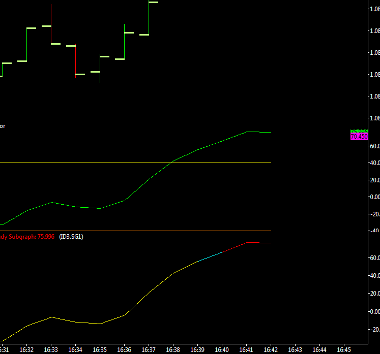

[2020-08-25 15:01:37]
User681150 - Posts: 62
i was successfully able to change the color of the subgraph line using ACSIL .DataColor when a condition was met (stoch > 60). i assume this was possible because .DataColor has the [sc.Index] capability sc.Subgraph[0].DataColor[sc.Index]
i now want to also change the width of the line at the same condition. so .LineWidth = 2;
is this possible with ACSIL? i have tried and it changes the entire line. i am assuming because LineWidth doesnt support [sc.Index]. is this assumption correct?
if not, what code can i use to change the line width only for the area that the condition is met? thanks alot
imageacsil change line.png / V - Attached On 2020-08-25 15:00:27 UTC - Size: 10.68 KB - 360 views

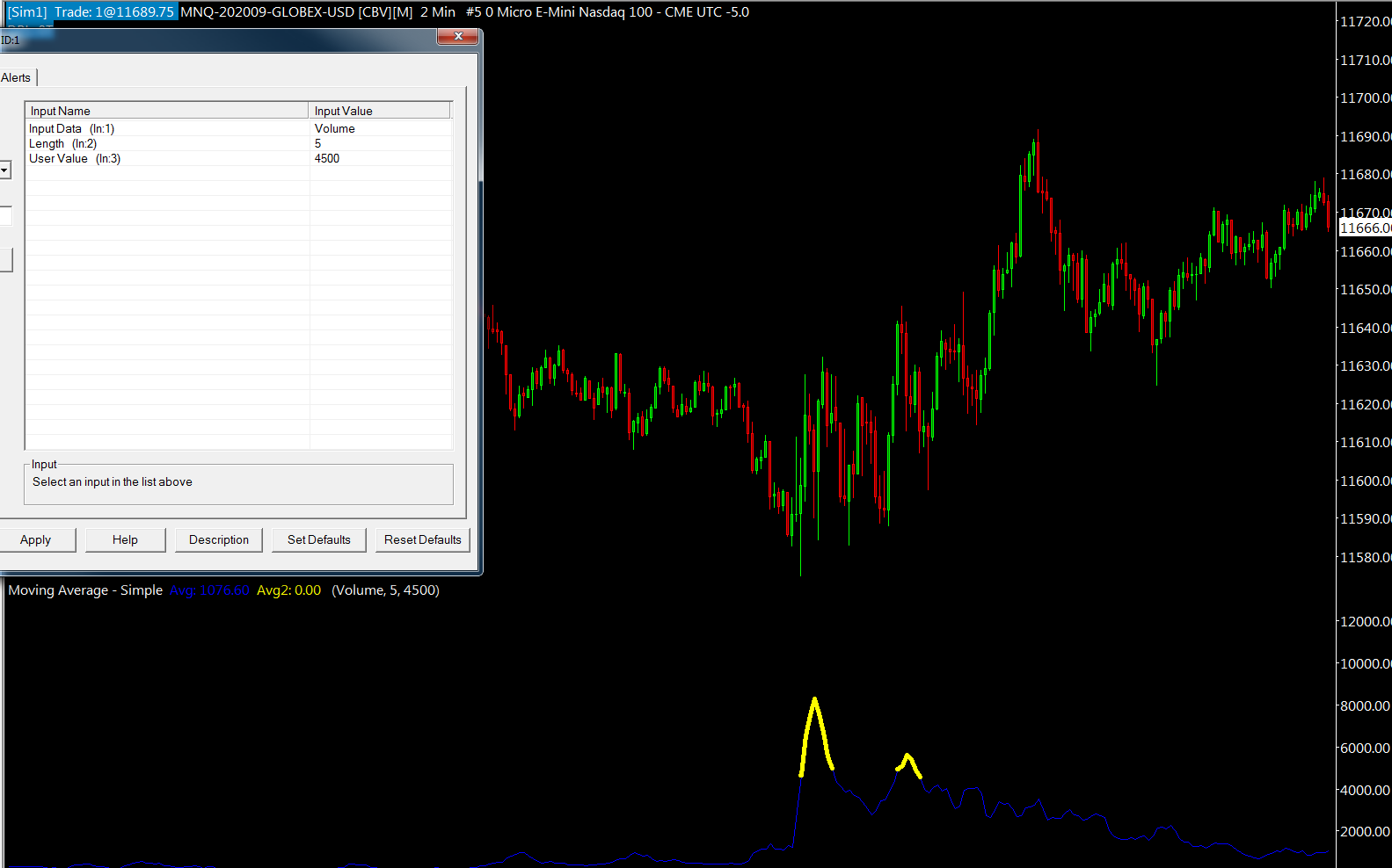

[2020-08-25 16:05:10]
Ackin - Posts: 1865
No it doesn't work ... you can have two lines (two subgraphs) that will overlap and one of them will be wide and in places where your area is not there you will assign it zero and turn it off with .Drawzeros = 0

[2020-08-25 22:41:33]
Ackin - Posts: 1865
Simple MA example
SCSFExport scsf_MovingAverageSimple(SCStudyInterfaceRef sc)
  SCSubgraphRef Subgraph_Avg = sc.Subgraph[0];
  SCSubgraphRef Subgraph_Avg2 = sc.Subgraph[1];
  SCInputRef Input_Data = sc.Input[0];
  SCInputRef Input_Length = sc.Input[1];
  SCInputRef Userval = sc.Input[2];
  if (sc.SetDefaults)
    sc.GraphName = "Moving Average - Simple";
    sc.GraphRegion = 1;
    sc.ValueFormat = 2;
    sc.AutoLoop = 1;
    Subgraph_Avg.Name = "Avg";
    Subgraph_Avg.DrawStyle = DRAWSTYLE_LINE;
    Subgraph_Avg.PrimaryColor = RGB(0, 0, 255);
    Subgraph_Avg.LineWidth = 1;
    Subgraph_Avg.DrawZeros = true;
    Subgraph_Avg2.Name = "Avg2";
    Subgraph_Avg2.DrawStyle = DRAWSTYLE_LINE_SKIP_ZEROS;
    Subgraph_Avg2.PrimaryColor = RGB(255, 255, 0);
    Subgraph_Avg2.LineWidth = 5;
    Subgraph_Avg2.DrawZeros = 0;
    Input_Data.Name = "Input Data";
    Input_Data.SetInputDataIndex(SC_VOLUME);
    Input_Length.Name = "Length";
    Input_Length.SetInt(5);
    Input_Length.SetIntLimits(1, MAX_STUDY_LENGTH);
    Userval.Name = "User Value";
    Userval.SetFloat(4500.0f);
    return;
  sc.DataStartIndex = Input_Length.GetInt() - 1;
  sc.SimpleMovAvg(sc.BaseDataIn[Input_Data.GetInputDataIndex()], Subgraph_Avg, Input_Length.GetInt());
  if (Subgraph_Avg[sc.Index] > Userval.GetFloat()) {
    Subgraph_Avg2[sc.Index] = Subgraph_Avg[sc.Index];
  else {
    Subgraph_Avg2[sc.Index] = 0;
[2020-08-25 22:42:10]
Ackin - Posts: 1865
+ result image
imageMA example.png / V - Attached On 2020-08-25 22:42:06 UTC - Size: 57.67 KB - 425 views
