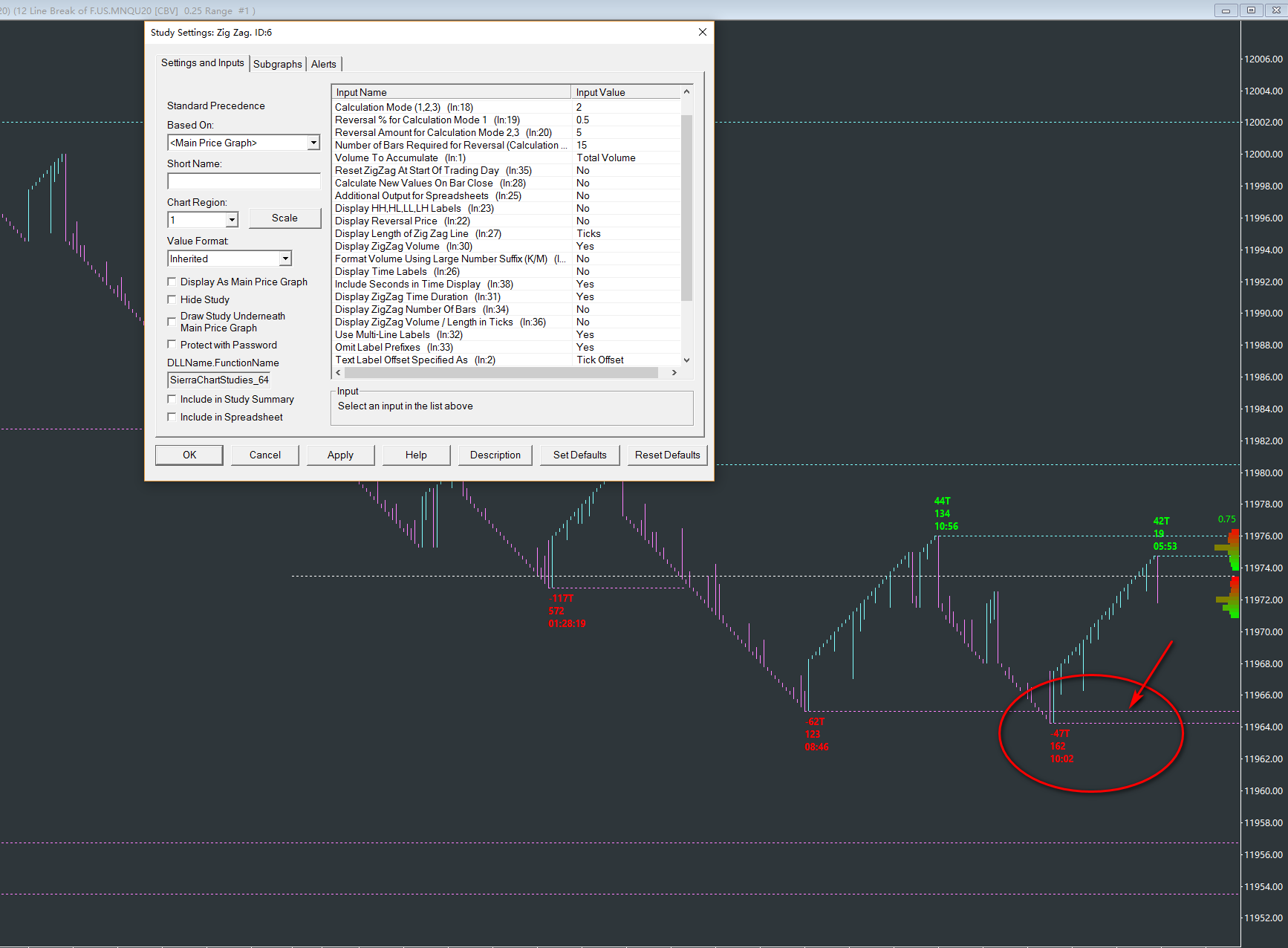

[2020-08-26 22:44:57]
User567294 - Posts: 47
here is my setting and problem line as arrow point to.
thanks
Rex

[2020-08-27 00:47:00]
Sawtooth - Posts: 4361
It works fine with most bar types, but it doesn't see some Renko bars.
This is a question for SC engineering.
[2020-08-27 02:36:16]
I am using range bar, but try on renko seems not working either. Can SC engineering have a look at this issue?
