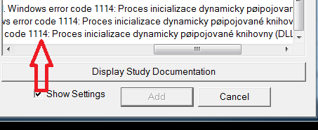

btw the problem with error message 1114 still persists, it's not possible to use more libraries ... again ... I'm not solving ... I'm just announcing it to the support
imageerror code 1114b.png / V - Attached On 2020-08-22 20:57:45 UTC - Size: 9.93 KB - 309 views

We do not know why you are getting error 1114. That is not a Sierra Chart issue. It is an operating system error. You seem to be indicating that you are loading a lot of DLLs?
