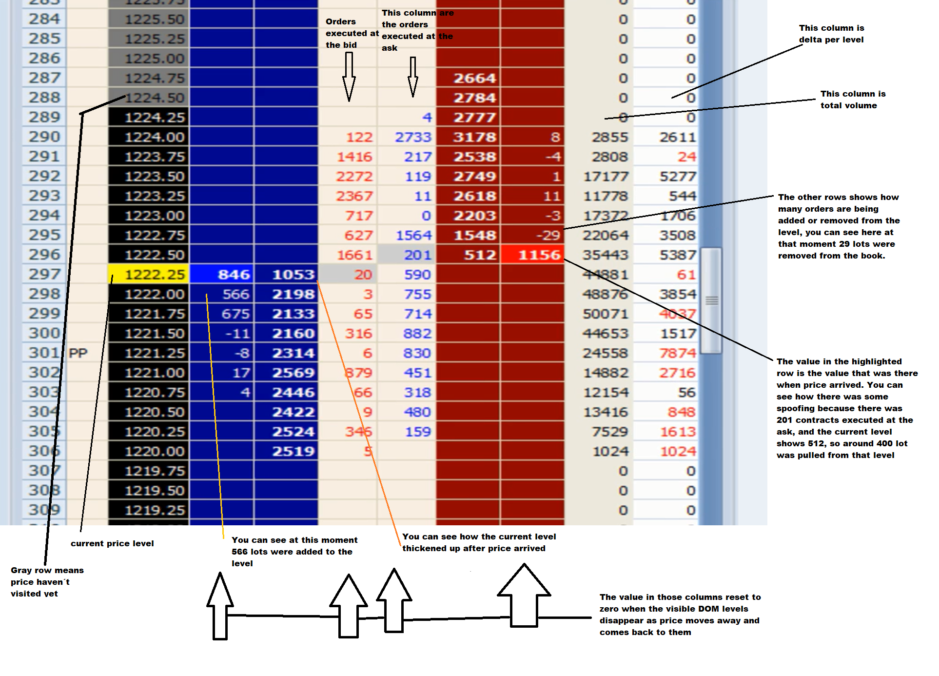

[2020-08-19 19:19:11]
User336770 - Posts: 30
Hi User336770, sorry we can't grant you further free access. Sierra Chart is a very inexpensive product, we know this. Many people support our development and out of respect to them, you would need to subscribe to go further. We hope you understand this.
Ok fair enough. I would like to know the answer to this question, though: Can Sierra output DOM and Time and Sales data to a .csv file realtime, and this file kept opened in excel refreshing realtime?
I saw a course here where they were using data from ninjatrader fed into this excel spreadsheet with extra features in the DOM, I was wondering if the same thing can be achievable in Sierra. I attached an image here. If yes I can hire a programmer to do it.
Best regards
imageDOM In Excel.png / V - Attached On 2020-08-19 19:18:14 UTC - Size: 1.49 MB - 337 views
[2020-08-19 20:38:52]
Complementing the question above, if not possible to open the file in excel and keep refreshing it, I would like to know if Sierra spreadsheet study is capable of recreating the DOM with extra features, like in the image attached above.
Regards
