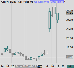

Hi there, I use sierra chart data for stocks, and every morning when I turn sierra chart on, on my daily chart, there’s always a couple bars missing, and i have to do the “delete all data and download” option to get all the bars. During the day whenever I'm switching to a different stock, the same thing happens, which really slows down my execution. I’ve used sierra chart for about 4 years and this only started happening lately. Could you help me to solve this issue please? Thanks in advance.
[2020-08-17 19:52:28]
It sounds like there is some issue with the downloading of historical daily data. We need very precise details about this. We need to see an image of the chart and also the Message Log at the time you notice this.
Instructions for these are on this page:
[2020-08-18 14:59:22]
User260560 - Posts: 37
Thanks for your reply, and here is the chart and message log
http://www.sierrachart.com/image.php?Image=1597762505324.png

[2020-08-18 19:12:00]
This involves a sub instance and also using Interactive Brokers.
This is the most recent historical daily data download:
HD Request # 82 | Downloading Historical Daily chart data for GRPN. Starting date: 1970-08-19. Service: DTCSubInstance | 2020-08-18 10:45:01.077
HD Request # 82 | Using server: 127.0.0.1 port 11098 | 2020-08-18 10:45:01.077
Socket (2) | Creating socket. | 2020-08-18 10:45:01.077
Socket (2) | Connecting to IP: 127.0.0.1. | 2020-08-18 10:45:01.077
HD Request # 82 | Setting DTC encoding to Binary VLS | 2020-08-18 10:45:01.121
HD Request # 82 | Sending historical data logon request message. | 2020-08-18 10:45:01.121
HD Request # 82 | Requesting historical Daily data starting at 1970-08-19. | 2020-08-18 10:45:01.122
HD Request # 82 | Decompressing data. | 2020-08-18 10:45:01.124
HD Request # 82 | Receiving historical Daily data for GRPN starting at 2011-11-04 | 2020-08-18 10:45:01.146
HD Request # 82 | Writing historical Daily data to the file GRPN.dly | 2020-08-18 10:45:01.147
Socket (2) | CloseSocket call. | 2020-08-18 10:45:01.165
Socket (2) | Shutdown started. Waiting for graceful close. | 2020-08-18 10:45:01.165
Socket (2) | Socket gracefully closed by remote side. | 2020-08-18 10:45:01.166
Socket (2) | Closed. | 2020-08-18 10:45:01.166
Historical data download thread signaled to stop. | 2020-08-18 10:45:01.168
HD Request # 82 | Received 2205 records from 2011-11-04 00:00:00 to 2020-08-11 00:00:00 (8.8years) and wrote 2205 records for GRPN | 2020-08-18 10:45:01.168
HD Request # 82 | Completion time: 0s | 2020-08-18 10:45:01.168
HD Request # 82 | Daily data download complete for GRPN. Unique request ID: 82 | 2020-08-18 10:45:01.168
Removing historical data download ID 82. | 2020-08-18 10:45:01.168
What triggered this? Did you fully re-download the data in the historical daily chart for this symbol?
Although as we think about this, in the main instance, if there are no Historical Daily charts open for the symbols which are not updating in a sub instance, then there might not be any periodic Historical Daily downloading which occurs. We will need to implement that.
Date Time Of Last Edit: 2020-08-18 19:15:45
[2020-08-18 19:56:11]
We think we may have identified why there is an issue but not necessarily. It could explain the chart not having the most current day but not more than one day missing. We will have a new release out tomorrow which may resolve this.
Date Time Of Last Edit: 2020-08-18 19:56:50
[2020-08-18 20:08:37]
Hi, thanks for your reply.Yes the one i submit is from a sub-instance, but both main instance and sub-instance have the same problem. Today's daily candle is there, but missing previous couple days data, need to do "delete all data and download" to get all the daily bars. Great to hear that, I will test it out with the new release and will let you know if the problem is not resolved.
