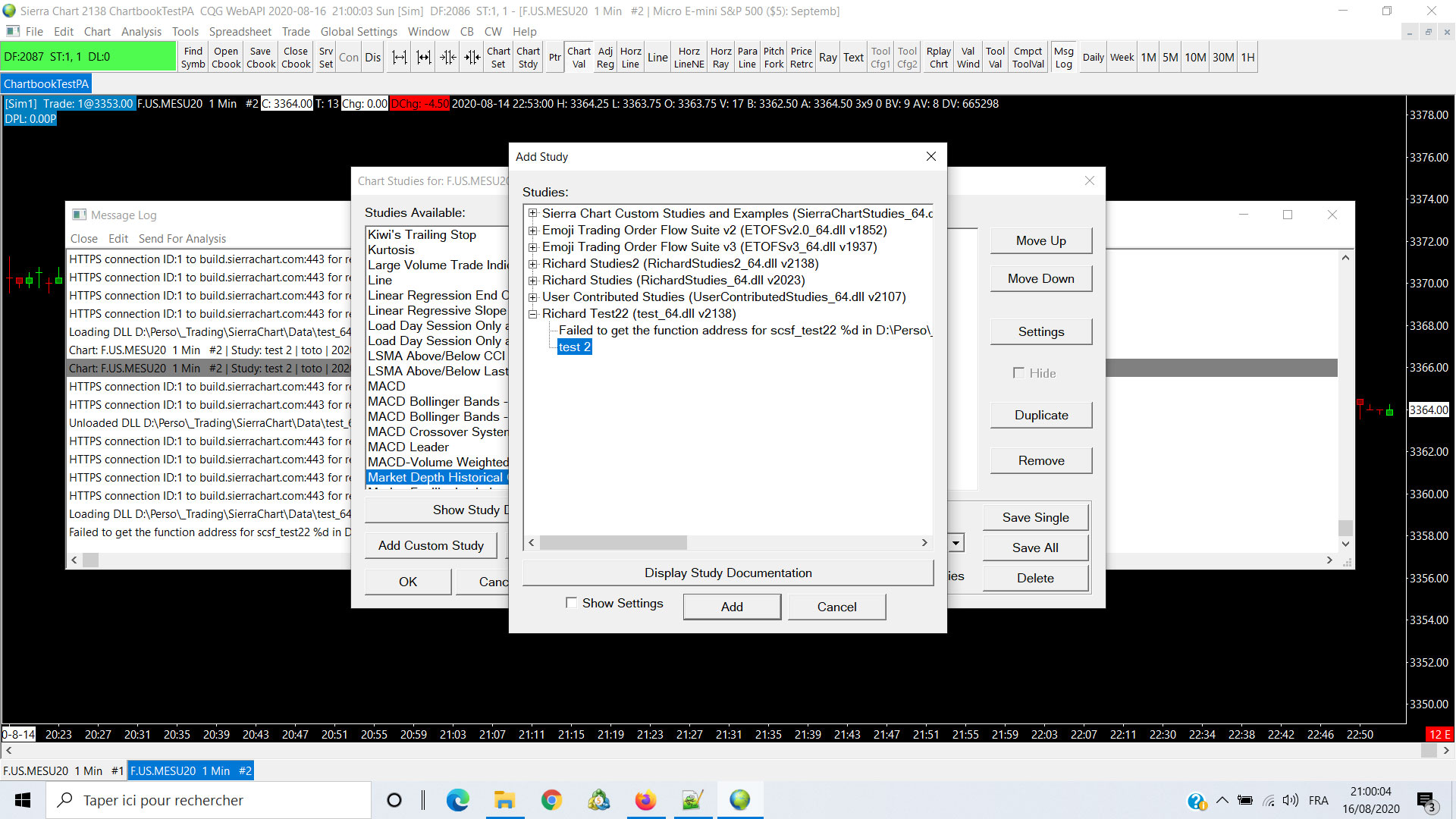

I have an error on a program that I do not understand. So I made a simple program in the attached file.
Line 23 seems to be the problem.
This code compiles very well (remote). But when I click on "Add custom Study" in sierrachart I have the following message in the logs:
Failed to get the function address for scsf_test22 %d in D:\Perso\_Trading\SierraChart\Data\test_64.dll.dll. Error: Windows error code 127: La procédure spécifiée est introuvable. | 2020-08-16 20:59:44.372 *
This message is also displayed in the custom studies window as you can see in the attached image.
Usually the SCStrings format works fine.
Thanks for your help,
Richard.
attachmenttest.cpp - Attached On 2020-08-16 19:09:21 UTC - Size: 411 B - 489 views
imageerror-20200816.jpg / V - Attached On 2020-08-16 19:09:55 UTC - Size: 454.09 KB - 412 views

Thanks for your reply,
I deleted the space after 22 as you indicated to me. After recompiling I got the exact same error message. On the other hand, if I comment out the line "Message.Format (..." I no longer have an error message.
What is amazing is that I often use this function and it works very well but here there is an error message and the desired message is displayed anyway.
Here are messages displayed in logs after compiling and executing this study:
Loading DLL D:\Perso\_Trading\SierraChart\Data\test_64.dll | 2020-08-17 15:25:15.466
Failed to get the function address for scsf_test22 %d in D:\Perso\_Trading\SierraChart\Data\test_64.dll.dll. Error: Windows error code 127: La procédure spécifiée est introuvable. | 2020-08-17 15:25:15.657 *
Chart: F.US.MESU20 1 Min #2 | Study: test 2 | scsf_test22 100 | 2020-08-17 15:25:20.304 *
As you can see the number 100 is displayed twice as expected.
Best regards,
Richard.
