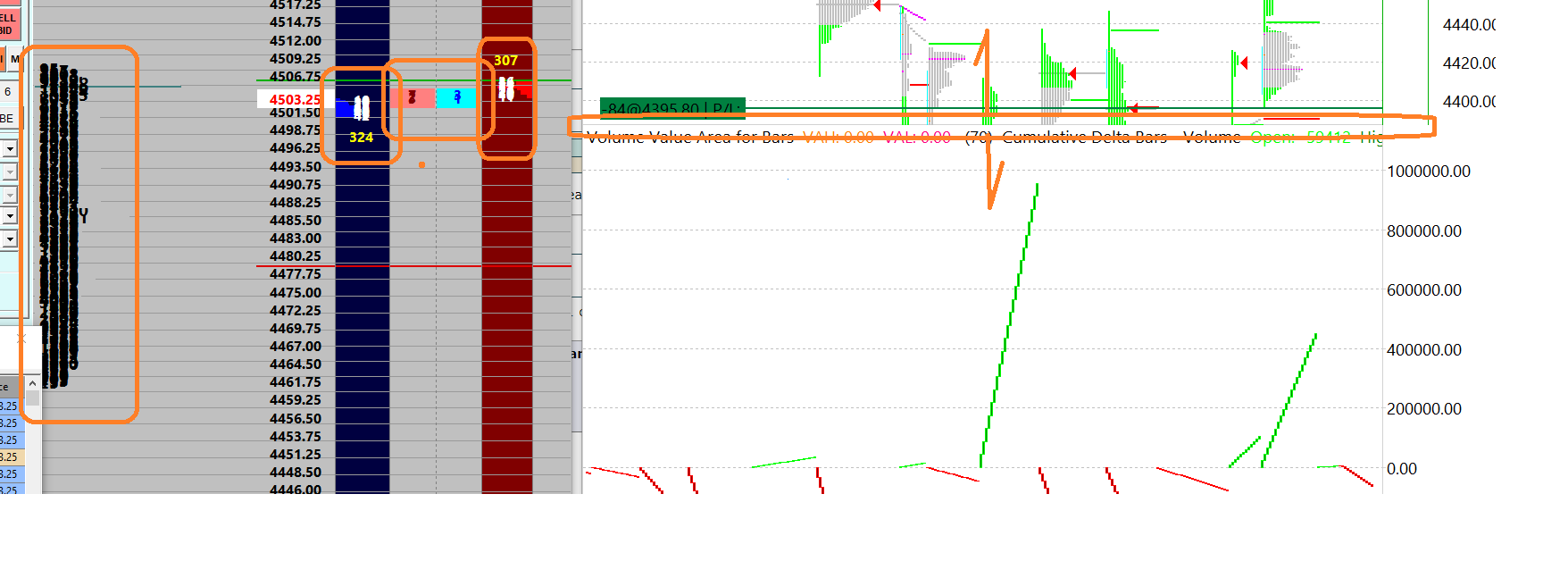

Zooming in/out could work like on common photo and / or PDF viewer = based on mouse location / spot on the window of SC and scrolling with mouse holding some key like ctrl and all data - fonts, rows, columns - respectively increase/ decrease 360 degrees around the spot of the mouse indicator / arrow . Doable? Thank You!
imageZooming on sierra chart 1 feb 22.png / V - Attached On 2022-02-01 08:01:31 UTC - Size: 60.52 KB - 541 views
