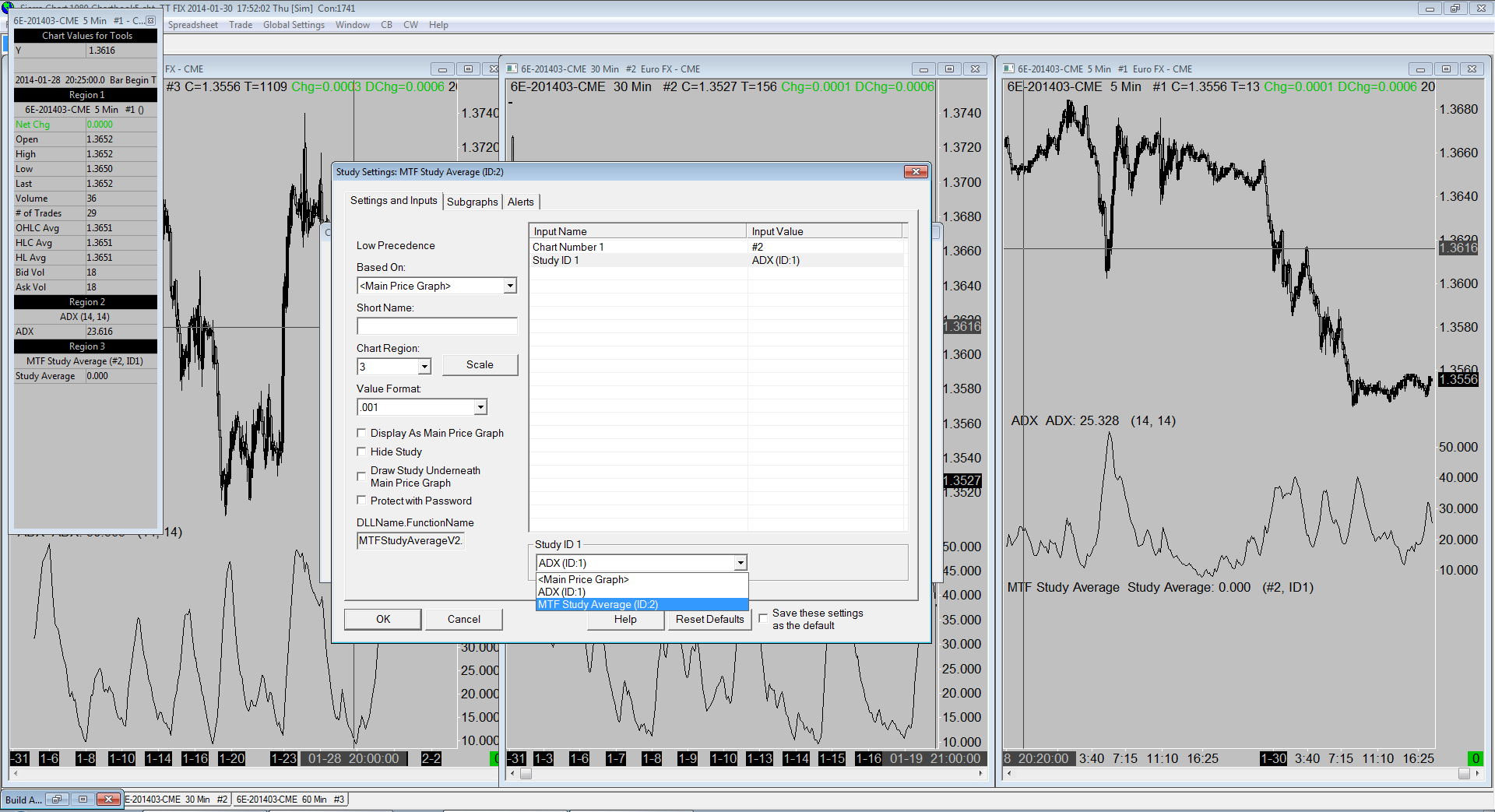

Hi, sorry but I can't make this work to save my life, I am just trying to reference other charts in ASCIL and I can pull from the chart the study is loaded on, but not other charts, and even though I have it set to another chart it shows the studies from the current chart in the drop down list. Please see pic if I am not being clear.
Should this code correctly pull from chart 2, study 1, subgraph 1 when loaded on chart 1?

[2014-01-31 04:19:17]
You are not using the correct input type. You need to use the Study input type which combines both a Chart and a Study as one input.
You need to use this:
https://www.sierrachart.com/index.php?l=doc/doc_ACSIL_Members_scInputs.html#scInputSetChartStudyValues

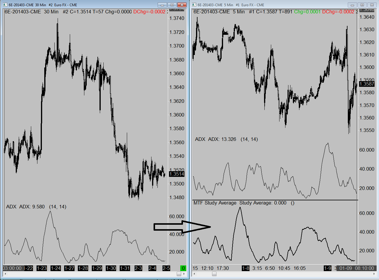

[2014-02-05 05:53:36]
vegasfoster - Posts: 444
Ok, so I happened to scroll way back on Chart 1 and I can see what is happening now, it is plotting the ADX from Chart 2 bar for bar on Chart 1, it is not matching up the time index and stretching it out, see pic. Should I be doing something with the indexing, or something else, or is this hinky behavior? I looked at the example you referred to and it shows getting the other charts index values, but not using them for purposes of the subgraph plot.

[2025-02-20 18:09:35]
JohnR - User831573 - Posts: 338
I think you need to look at the value you use to "Index" to the other chart. Chance are there is a different # of bars (index) in that other chart. If you are only looking for the last / current bar in the other chart use something like the following
SCFloatArrayRef SubgraphArray = StudyData[0];
Average[sc.Index] = SubgraphArray[SubgraphArray.GetArraySize()-1];
Hope this helps
