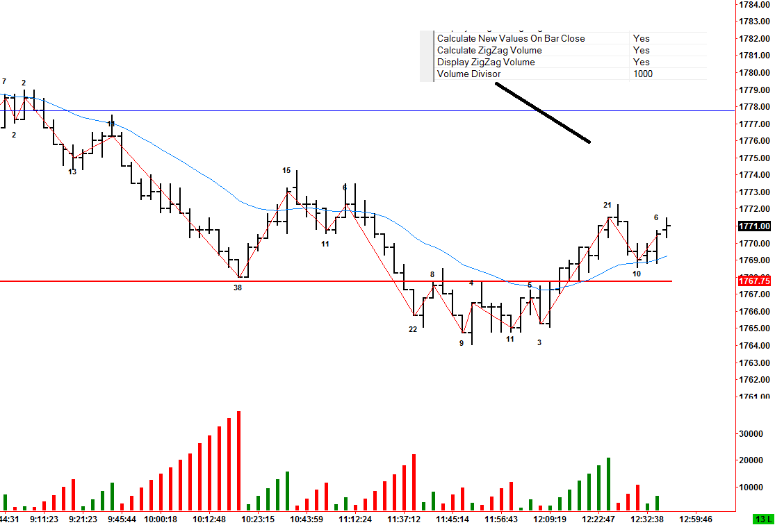

Can anyone tell me how to round the total volume values in the zig zag study. For example in the ES, the total volume swing of say "275556" would be rounded to "275" or "276". This would be much easier to read. Thank you.
[2014-01-31 12:54:34]
Graham - Posts: 44
It can be done....
imageES.png / V - Attached On 2014-01-31 12:54:01 UTC - Size: 37.53 KB - 1489 views

Graham - Posts: 44
The ZigZag study in part is similar to the Weis Wave, and the volume divisor is part of the WW that's available on other platforms. There was a discussion about the WW a long time ago on this forum (it's probably on the old support board) and what you see on the current ZigZag study includes a lot of that discussion/requests.
About a year ago I commissioned a programmer to basically write the equivalent of the Weis Wave for me to use on SC which is what you're seeing from that screenshot. Given that I paid for that development I'm not prepared to share it.
As I said, the current ZigZag study is now very close to what I have. I'm not a programmer and would not know how much work is involved, but it can be done.
