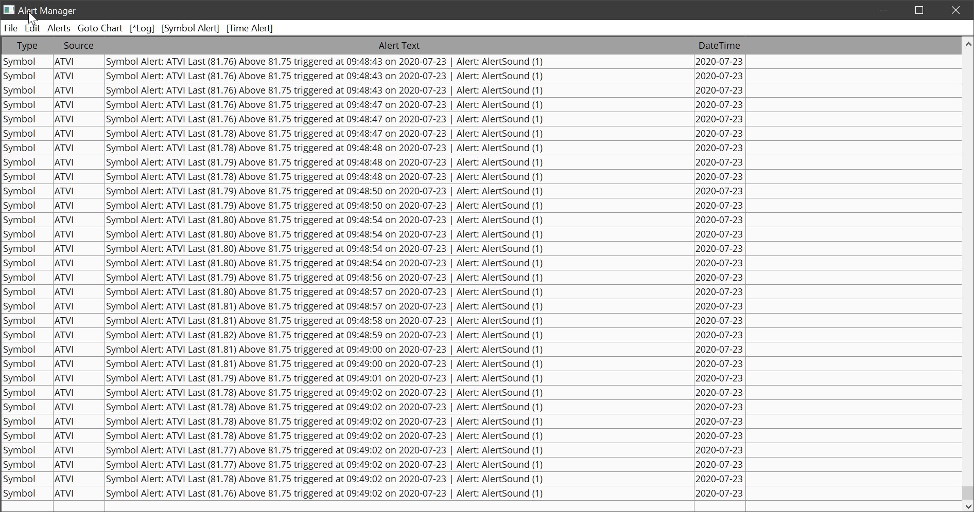

there seems to be something wrong with the Alert manager.
I have an alert that says last is above given price. Continuous monitoring. Now if the price rises above that price, and stays above, the alert constantly goes off, which can only be malfunction. This makes no sense. And it is described in the documentation that the condition stays true until it goes false once again. Which is the only way it makes sense. But it does not behave like this. I get constant alerts. I attached a screenshot. You see the price is constantly above and it constantly alerts...
Another error is : when the price is gone back way down below the alert price already and you want to activate the same alert it constantly alerts for all the alerts happened minutes or even hours before already with continuous. If you switch it to One time you cannot even enable it anymore, it is shortly enabled, then alerts even if condition is not given, logs a price that was there minutes ago, while the actual price is way below the condition, and immediately deactivates the alert again.

[2020-07-23 20:29:21]
We will resolve these issues in the next release.
[2020-07-24 02:25:26]
We have released a new revision of 2141. These issues are now resolved. Thank you for letting us know.
[2020-07-24 05:27:33]
TeeJay - Posts: 123
Thank you for fixing this so quick. I use this quite a lot. Will try it out today.
