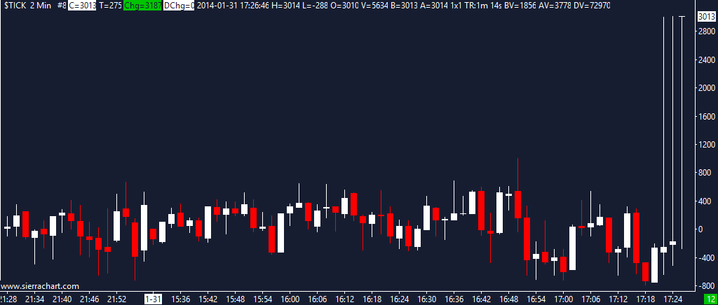

User93931 - Posts: 6
I am too having troubles with $TICK right now. When I am use "Delete All Data And Download" then historical chart seems to be correct, but real time streaming is crazy. The values oscillates between +3000 and -1000. I am using Sierra Chart P5 built-in data for the $TICK. Today I updated SC to the new 1088 FIX/FAST version if this may be cause of the problem...

[2014-01-31 16:19:34]
The data looks good to us and we do not observe what is being described. Please post an image of the chart, by following these steps:
https://www.sierrachart.com/index.php?l=PostingInformation.php#Image
[2014-01-31 16:27:34]
Well, here goes the link:
http://www.sierrachart.com/image.php?l=139118560795.png
[2014-01-31 17:28:18]
The data is definitely good and we do not know why this is happening in your particular case. We will have to run a test when using OEC.
[2014-02-03 15:43:54]
Hi, today this issue happened again to me. At 9:17 AM (Chicago Time) the Sierra Chart disconnect it self and then reconnect to data feed again - it happens to me sometimes now with the new FIX/FAST version. After it the $TICK started to show me the "wrong candles" again... Now I switched back to the version 1066 and the $TICK is okay now...
I am just wanted to let you know... I will stay with 1066 for now and if you will figure out what may be the problem, then let me know, thank you.
Note: I've tried a few times to install 1066 SC version and then I go back to the 1088 but reinstallation did not help.
Tomas
[2014-02-04 01:09:53]
We now recognize why this happens. And it will be resolved in version 1089.
We recommend using version 1078 for the time being:
http://www.sierrachart.com/downloads/1078SierraChartSetupPrerelease.exe
