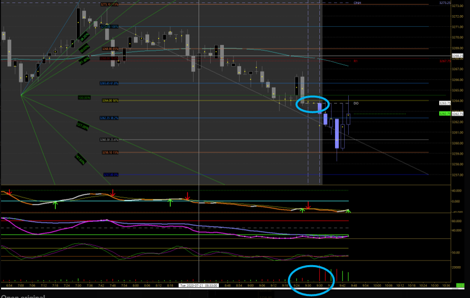

a few users are seeing multiple bars with same time on time axis. At first we thought it was the Time highlight study since removing it would help. But then the problem came back. Any suggestions?
An example is attached below around 9:30 time frame. But we've seen this issue on tic charts and with and without Time highlight study
Also the people having problems interface to Transact , those that do not don't have the problem. Not sure if this is a coincidence or not
Date Time Of Last Edit: 2020-07-21 18:31:48
imagebar time issue.png / V - Attached On 2020-07-21 18:21:31 UTC - Size: 129.89 KB - 377 views
[2020-07-21 19:10:29]
There can be a data feed time stamping issue causing the problem. So yes this can be data feed specific.
Also that screenshot is illegible.
