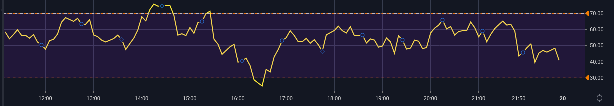

Shortly, I compared the RSI settings and outputs among Sierra, Tradingview, Investing and Barchart. Only Sierra gives a completely different output.
I tried with RSI-W, as well, or RSI with different Average Types (e.g. Exponential Moving Avg). Same result. Apparently, there is no way to match exactly the other RSI outputs with the Sierra one.
Reading the documentation has not helped either.
I am attaching the screenshot from Sierra and TradingView for ES future 5 minutes. I hope it helps to understand what I mean.

[2020-07-19 22:51:49]
User90125 - Posts: 715
Just use the RSI with the Exponential Moving Average (EMA) set. That's it.
For some reason, Sierra sets the default on the non-Wilder RSI to Simple Moving Average (SMA)??? instead of the standard EMA, which most other charting services are using these days.
However, if you want the RSI that matches the original Wilder RSI, just use the study RSI-W, or change the Moving Average on the non-Wilder RSI to Wilders Moving Average instead.
Also, if you want RSI to match the Tradestation formula, use the study RSI-TS.
[2020-07-20 03:48:23]
But they did already use the RSI with the Average Type set to Moving Average-Exponential, as you can see in the first post.
And thank you for reminding us about the Tradestation RSI version. We were thing about that, but did not have time to look into details of what we did on that. We will add that to the main list of studies.
