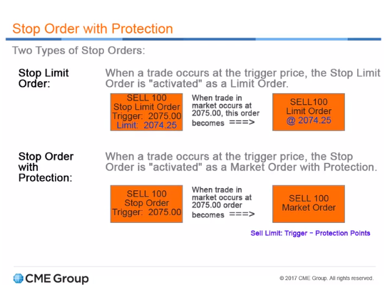

Thanks, ondafringe! After watching the video, at 5:04, it looks like the CME distinguishes between two orders, a stop limit and a stop order with protection. How do we use the stop order with protection in Sierra?
The stop limit doesn't seem to stop you out at your stop price (with a market order) but rather at the limit price which is set - in my case for MGCQ20, it was 4 ticks and in another case, it was 5 points!
A stop order with protection will do as you mention above, a market order that sweeps the book until it hits the protection price and then a limit price is set for the rest of the unfilled order.

I only became aware of this about a month ago. So, again, this is my understanding of how the Stop w/Protection works:
Simply stated: As far as I can tell, it's all automatic. The exchange does it for you, like it or not. So there is nothing to set in SC, other than your resting Stop.
Meaning: When you set a resting Stop... the exchange automatically adds/subtracts the Protection Points for that product... and then sets a Stop-Limit order at the Protection Point price. When the resting Stop is triggered... it becomes a Market order... and the Stop-Limit becomes a Limit order.
So for ES/MES, if you had a Buy Stop set at 3200, the exchange would automatically add 3 points to the resting Stop price, and automatically set a Buy Stop-Limit order at 3203. If your resting Stop is triggered... and you aren't filled within those 3 points, you will not be Stopped Out of your position.
Protection Points are determined by the exchange based on the product you trade. As for CME, Protection Points are equal to 1/2 the non-reviewable trading range for that particular product. So for ES/MES, the non-reviewable trading range is 6 points, so the Protection Points would equal 3 points. You'll have to look around on the exchange to determine the Protection Points for the product you trade.
I understand this now, thanks!
I verified on a recent trade of M6E that for a stop loss of 1.182, once executed, the stop limit "price" was 1.182 and "price 2" was 1.184. Once the stop was hit, a market order occurred and the system got me out at 1.182 (where my original stop was).
