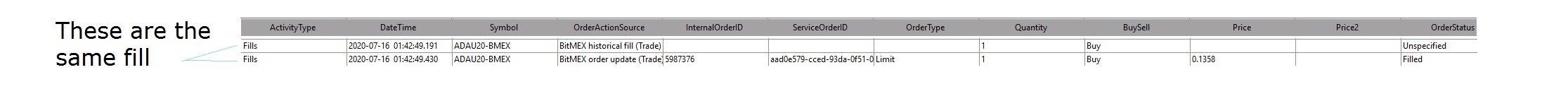

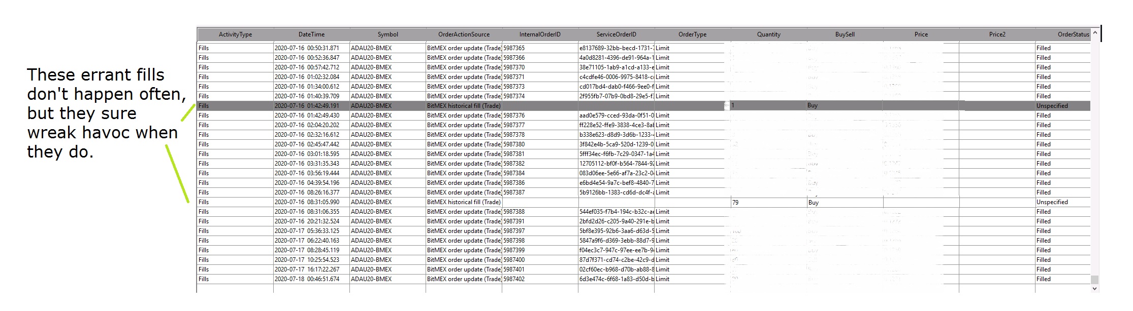

[2020-07-19 01:57:35]
rabbitTrader - Posts: 16
After additional investigation, it seems that these errant fills are historical fills. For past fills (from hours to days prior) that are to be drawn on the chart, this is okay. But these historical fills sometimes show up for new trades (usually around 300ms before the correct fill message), which confuses Sierra Chart into seeing two fills instead of one. (See screenshot attached.) A simple solution would be the ability (via check box or similar) to disregard historical fills.
