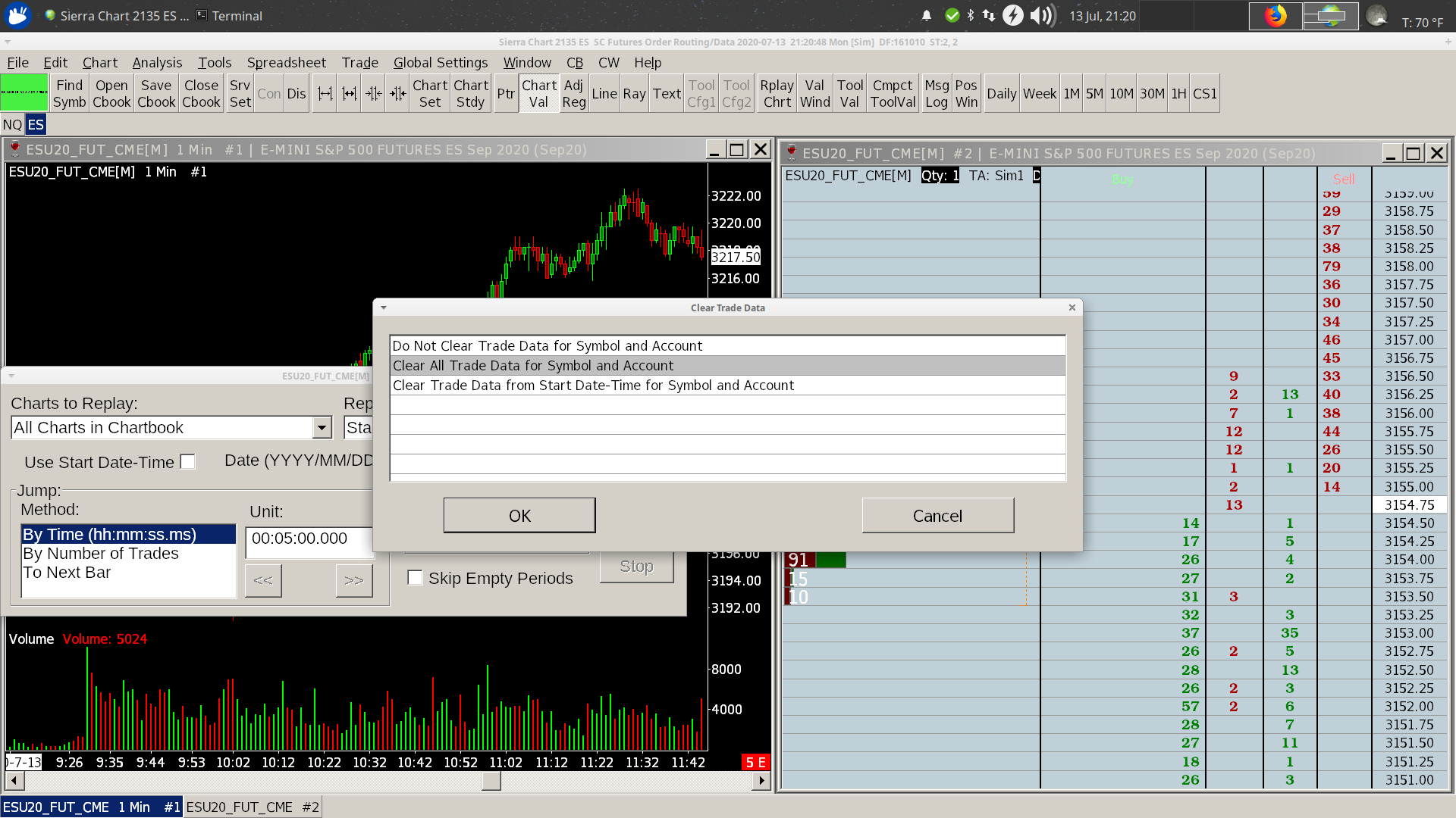

I am trying to replay a 1 minute chart and a trading dom in the same chartbook (see replay.png). As you can see, the market depth data is set to be downloaded (I have disconnected and then reconnected). The problem is the replay speed is getting set to 0.00x instead of 60x.
I have tried Edit->delete all data and download and setting the replay speed to 1440, as suggested in the documentation.
The first time I tried to replay, a window came up with three options and prompted me to delete all trade data, which I did (tdata.png). I have also tried after checking Trade->Trading Locked. But the replay speed is 0.00x no matter what.
imagereplay.png / V - Attached On 2020-07-14 01:09:06 UTC - Size: 314.71 KB - 346 views
imagetdata.png / V - Attached On 2020-07-14 01:21:39 UTC - Size: 258.15 KB - 422 views

Thank you for getting back. The inability to set replay speed does seem to be a Linux issue. On Linux, the first replay works but the later replays are stuck at 0x speed.
I have tried replay from a windows laptop and it works. However, the inside bid-offer are shown as 1 and the other bids and offers are not shown (see rdom.png attached). Is there a way to see the bids and offers in a replay?
