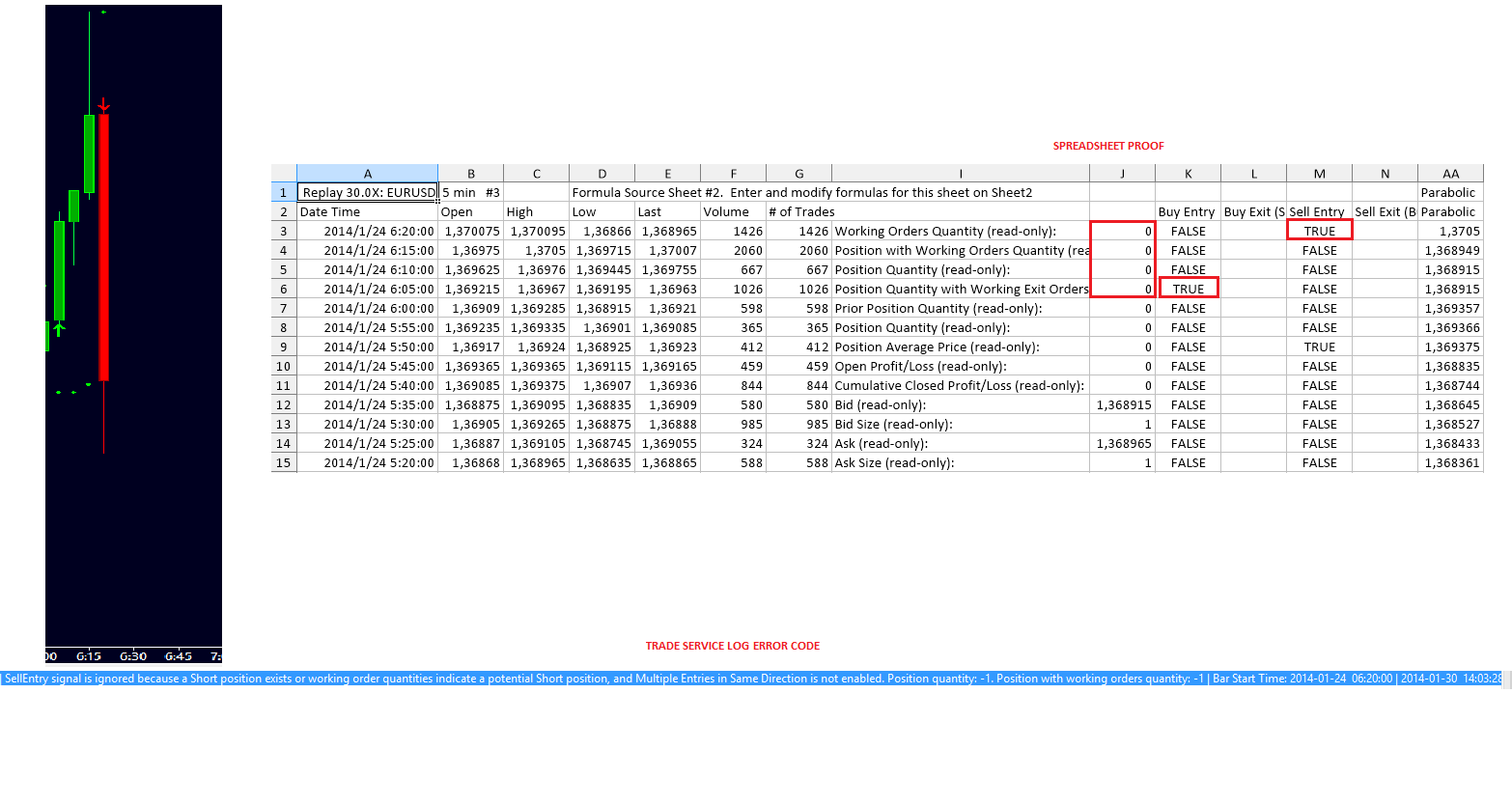

I made a slow replay backtest, with the psar as trade signal. when a psar dot appears, a trade must be opened.
to really see why orders are not launched and many signals ignored, i opened the trade service log, and detached the chart from the spreadsheet to follow each walk of the process carefully.
I also had read the link you provided about the ignored signals. And i see that on the trade service log, there are false position quantity and false position with working orders quantity(-1 and -1). The problem is this is not true, because there is no launched orders as i began the replay backtest at this time.
You can find an attached file that prove that. You can see the chart, with the arrow indicating the normal orders entry bars for the buy and for the sell, the spreadsheet with 0 at position quantity and 0 at working orders quantity, and with the message of the trade service log.
This is why so many rders are not launched by the spreadsheet, but for me the reason is a non sense.
Help me please, Thanks

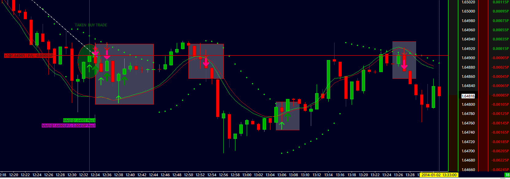

User57878 - Posts: 24
There is still many missed trades:
See in the picture, the first green arrow up signals a buy, the trade has been taken(green circle zone), but the following sells orders are left. All the following orders are left(grey squares). The study settings are good(reversals and others).
I don't understand what's happening. Maybe a bug of sierra.
