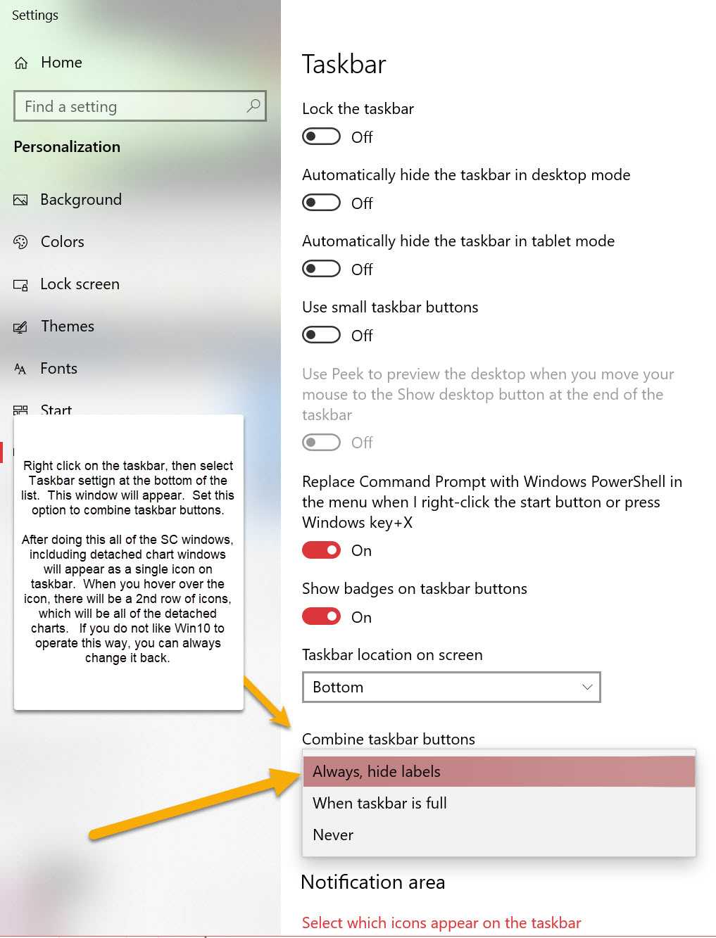

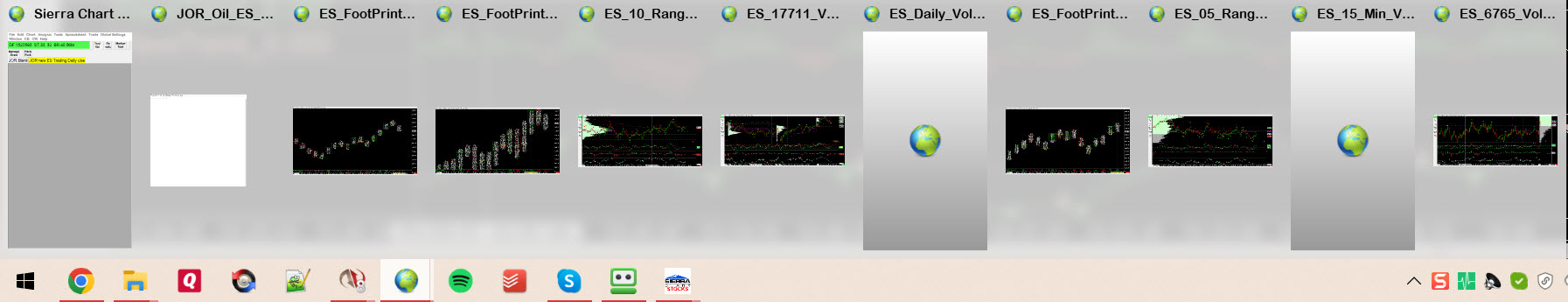

If you change the way Win10 shows icons, you can only see one icon per similar windows.
Right click on the taskbar, then select Taskbar setting at the bottom of the list. This window will appear. Set this option to combine taskbar buttons.
so, all copies of a program / window will be combined / stacked into one icon on the taskbar.
Example -- if you have 3 copies of File Explorer open, there will be one File Explorer on the task bar. Clicking the FileExplorer icon in the win10 taskbar, will make a 2nd row of icons appear above it, of the actual instances "windows" of file explorer.
If you have SC charts as detached, then after doing this all of the SC windows, including detached chart windows will appear as a single icon on taskbar. When you click over the icon, there will be a 2nd row of icons, which will be all of the detached charts. If you do not like Win10 to operate this way, you can always change it back.
Hope this makes sense.
JohnR
Date Time Of Last Edit: 2023-03-21 15:15:45

[2023-03-21 16:01:17]
User588795 - Posts: 12
Thanks for your quick response :) Yup, I'm aware that I can group together icons on the task bar but I much prefer to keep them separated - it's the only reason why I've been avoiding the free upgrade to win11 lol
I suppose it's not possible to keep my charts attached to the main sierra application for this ahk script to work then? Do you have them detached?
