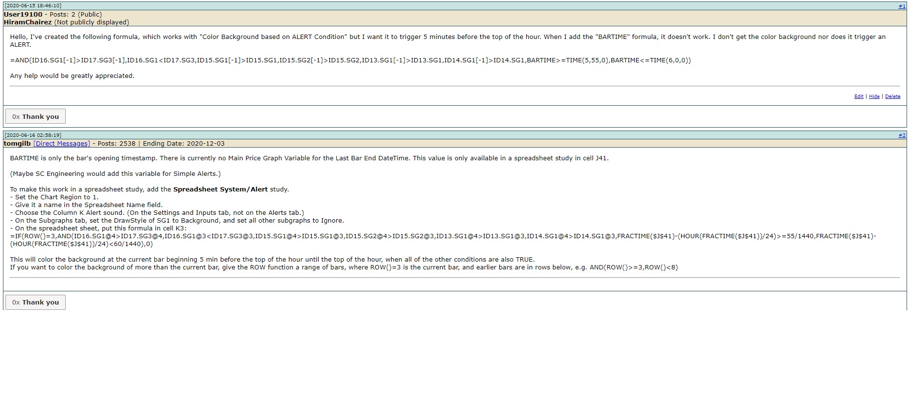

@tomgilb - Thank you for your reply. When I tried the line you posted, I received a Syntax error. Attached is my previous question and reply which resolved my first issue.
