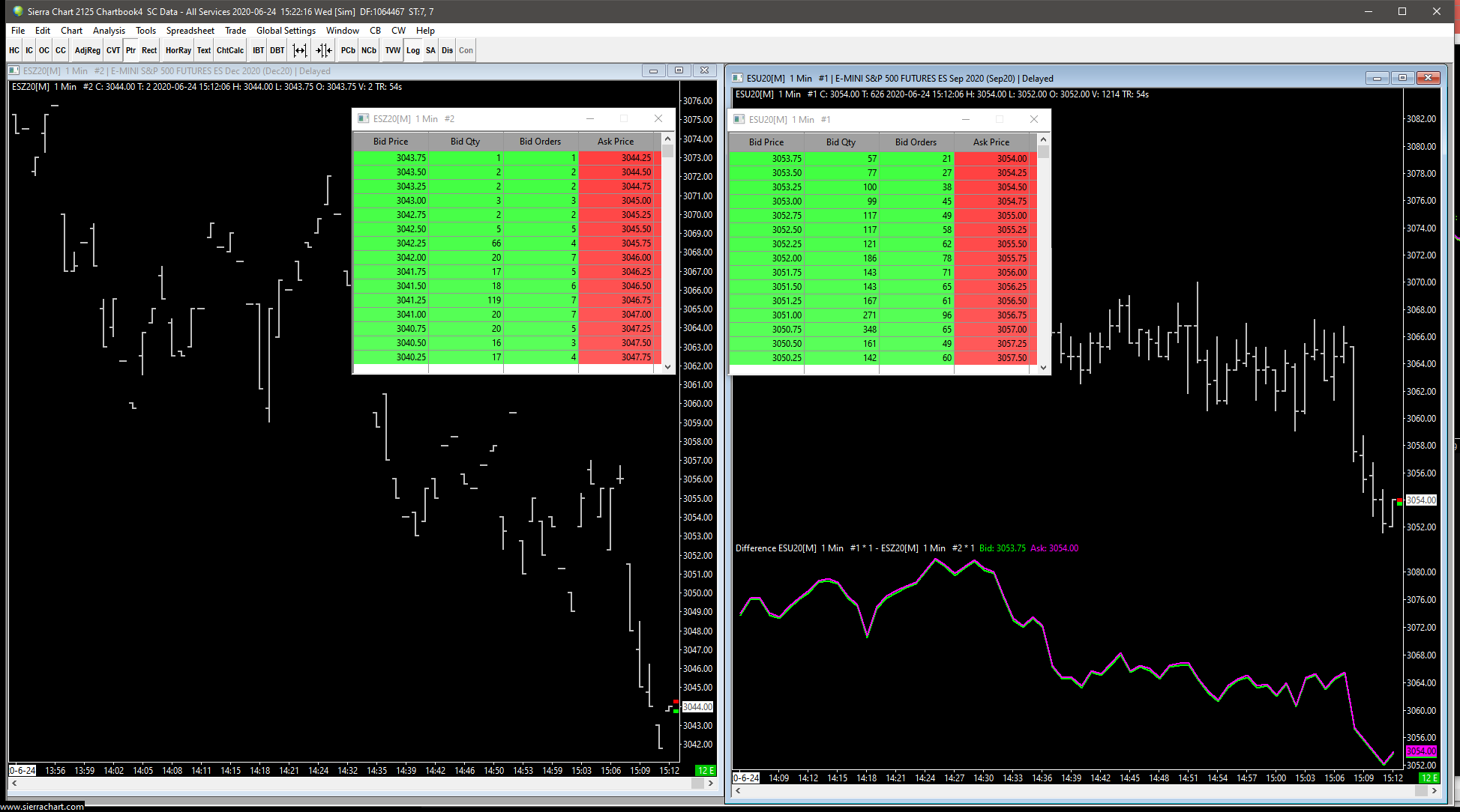

I made simple bid/ask spread between 2 different instruments using Difference (Bid and Ask Prices) and it seems that 2nd instrument is not calculated. I even set "Chart 2 multiplier" to a ridiculous number and the study output didnt change. please create a support ref number - Ill email you the picture to illustrate the issue.
Difference (Single Line) works however..

[2020-06-24 15:23:38]
maxima120 - Posts: 177
I checked. both instruments are by tick.
I just made a simple ESU20-ESZ20 spread for the test. both have a/b lines shown on the charts and both have order book live and working. the Difference study however doesnt work.
http://www.sierrachart.com/image.php?Image=1593012137441.png
Date Time Of Last Edit: 2020-06-24 15:24:04

[2020-06-29 20:18:42]
John - SC Support - Posts: 48480
You need to have the Bid and Ask Prices study added to the secondary chart in order to have the necessary data available to do the calculation. We have updated the documentation to make this clear. You will find the updated documentation here:
