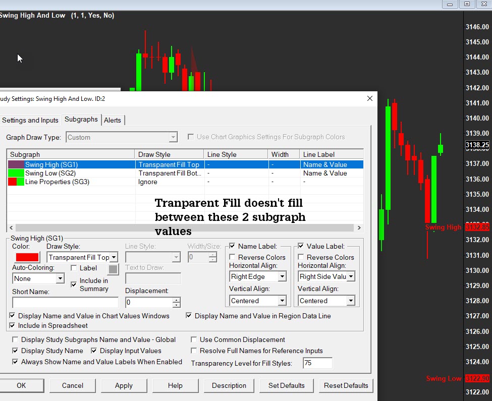

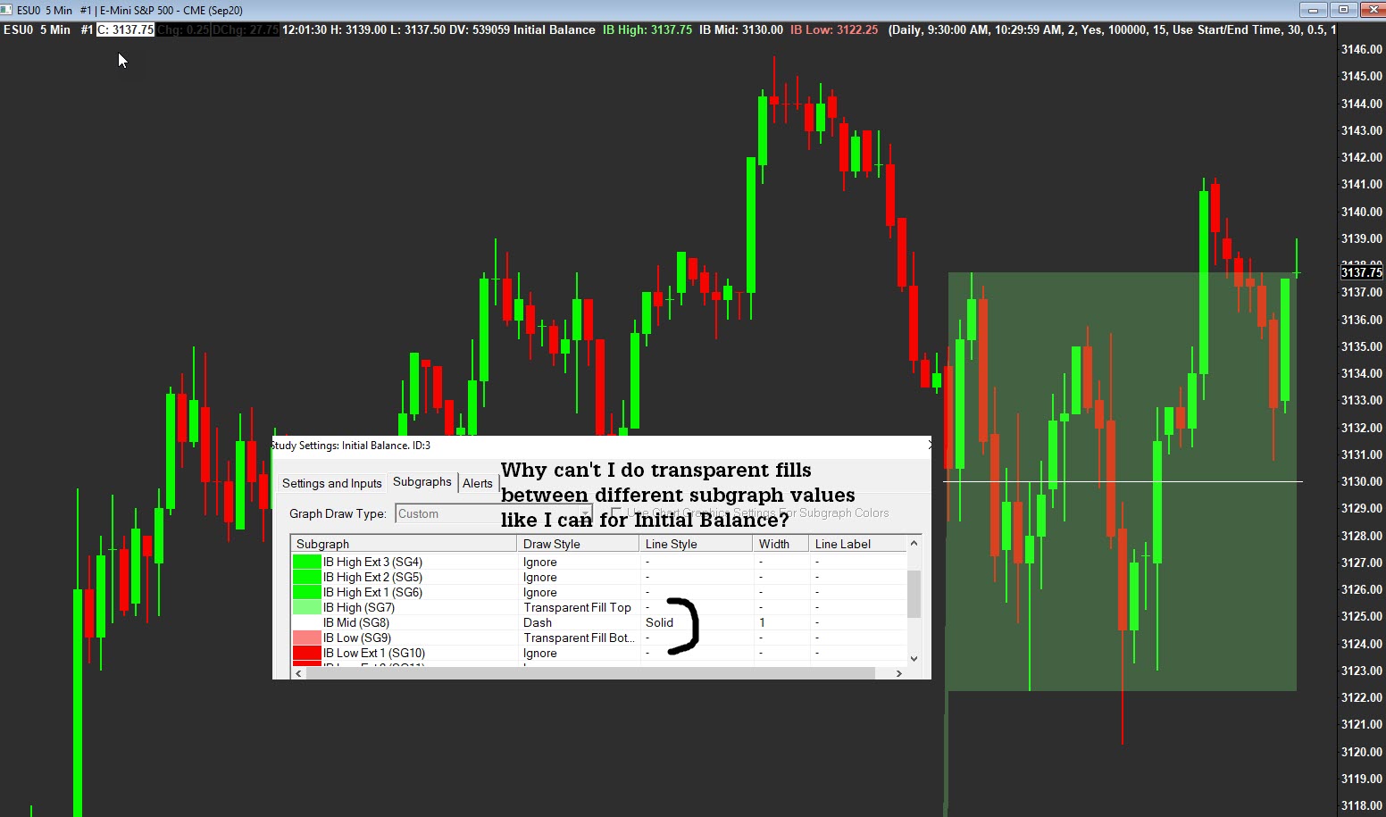

Want: Use Transparent fill between 2 subgraph values. (Rectangle an area)
I can use Transparent fill top/bottom on the Initial Balance script, but it will not work on the Swing High/Low script.
Why?
See attached images.

[2020-06-23 17:30:40]
The reason why is because the Swing High and Low subgraphs are mostly zeros. The only time they are not zeros is when there is actually a swing at a bar, and most of the time there will not be both a High and Low on a single bar.
The fill area Draw Styles require that there be a High and Low at the same time on a bar, and you really want to see it across multiple bars. The Swing High and Low study does not work that way.

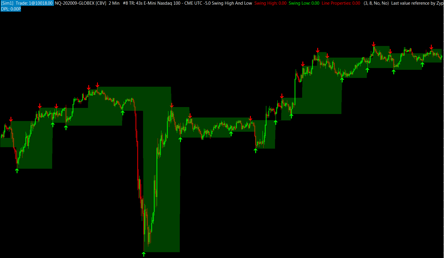

[2020-06-23 17:39:51]
Ackin - Posts: 1865
markuz)
Original Swing High/Low + study Last Value reference
contact link:
imageLast value example2.png / V - Attached On 2020-06-23 17:38:37 UTC - Size: 26.83 KB - 508 views
[2020-06-24 21:02:39]
markuz - Posts: 90
"I would like to draw a transparent rectangle fill between 2 Subgraphs.
I can get this to work with the Initial Balance script.
- does this mean for the rectangle transparent fill top (bottom) to create the rectangle the SG needs to be in the same script?
If this is possible please show how to do it?
Ackin, thank you for the image, but I don't know how you created the chart and looking up last value reference in the search didn't give me any answers.
Did you do it through the spreadsheet formula script?
Thank you for explaining/showing how I can do this aside from the Initial Balance script."
