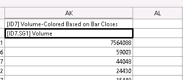

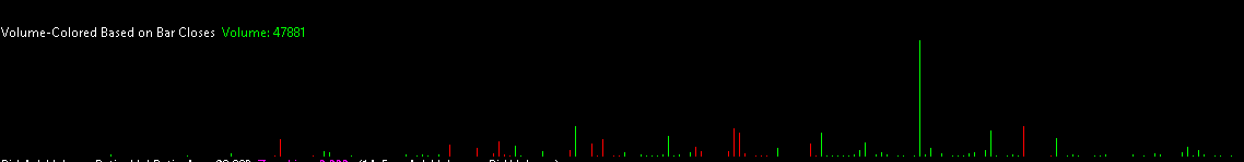

I would like to make a trading strategy on this indicator.
Problem: there is only one SG in the spreadsheet.
You can set the time for opening an order - by the magnitude of the indicator, but how to determine the direction of the order in the spreadsheet (the indicator gives a red or green color)?
imagevolume colored.png / V - Attached On 2020-06-23 07:17:34 UTC - Size: 11.54 KB - 472 views
imagesg1.png / V - Attached On 2020-06-23 07:17:48 UTC - Size: 40.52 KB - 423 views
imageAK3.png / V - Attached On 2020-06-23 07:17:58 UTC - Size: 10.47 KB - 424 views

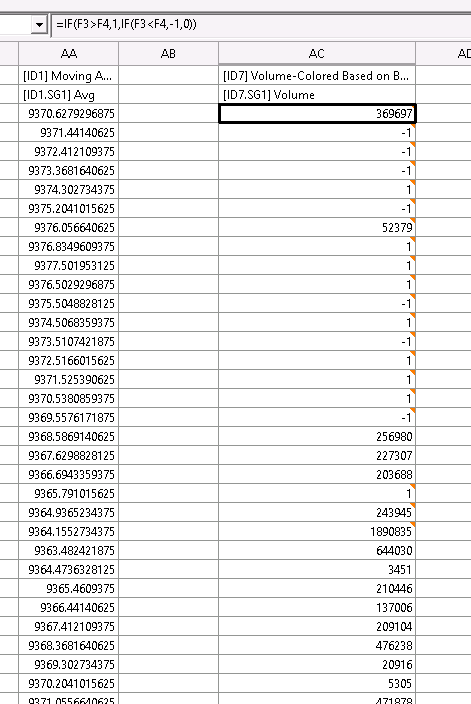

Use a Formula Column to calculate when the color changes.
Use this formula in row 3:
=IF(F3>F4,1,IF(F3<F4,-1,0))
This will return a 1 for the up-color, and a -1 for the down-color.

ULADZIMIR VALASACH - Posts: 38
placed in FS3 - it turns out wrong ...
imageAC3.png / V - Attached On 2020-06-24 13:04:05 UTC - Size: 32.43 KB - 468 views
[2020-06-24 13:32:44]
Sawtooth - Posts: 4361
You must use a Formula Column. If 'Number of Formula Columns' is set to 16 then you can only use columns K-Z.
Spreadsheet Study Inputs: Number of Formula Columns
If you are using the Spreadsheet System for Trading study, only use columns O-Z because columns K-N are for entry and exit signals.
So, for example, put =IF(F3>F4,1,IF(F3<F4,-1,0)) in cell O3, and reference it in your entry formulas in K3/M3.

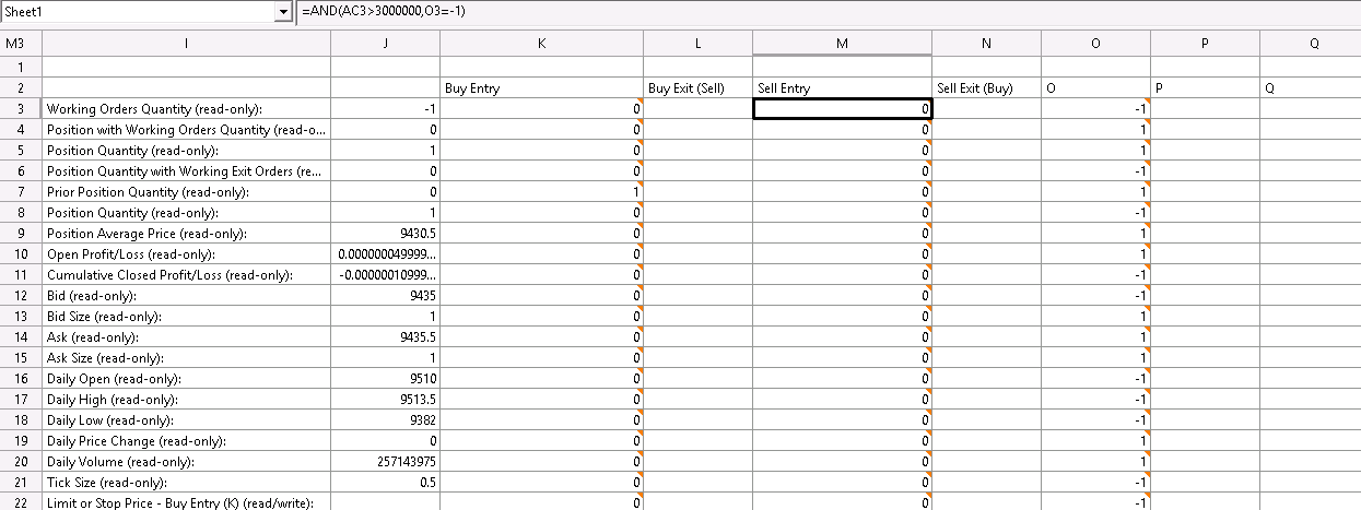

Set:
K3=AND(AC3>3000000,O3=1)
M3=AND(AC3>3000000,O3=-1)
Opens only buy orders!
imageset.png / V - Attached On 2020-06-25 06:51:18 UTC - Size: 40.01 KB - 446 views
imageonly buy.png / V - Attached On 2020-06-25 06:51:29 UTC - Size: 61.46 KB - 440 views

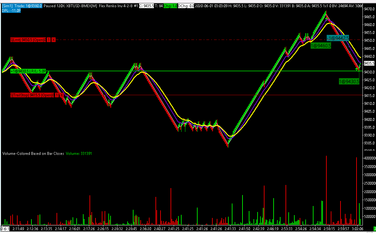

The formula I offered will only work when using Volume - Colored Based on Volume study, as you put in the title of this thread.
Sorry, I didn't notice in the pics that you were instead using the Volume - Colored Based on Bar Closes study.
I see that you are also using Renko bars. Apparently the Volume - Colored Based on Bar Closes study is not using Renko open and close values.
Try this:
1. Add the Renko Visual Open/Close Values study, and hide the study.
2. Use a formula like this in O3:
=IF(AF3>AE3,1,IF(AF3<AE3,-1,O4))
-where the Renko open is in AE3 and the Renko close is in AF3. Edit as needed.
3. Use these formulas in K3/M3:
K3: =AND(AC3>3000000,O4=-1,O3=1)
M3: =AND(AC3>3000000,O4=1,O3=-1)
