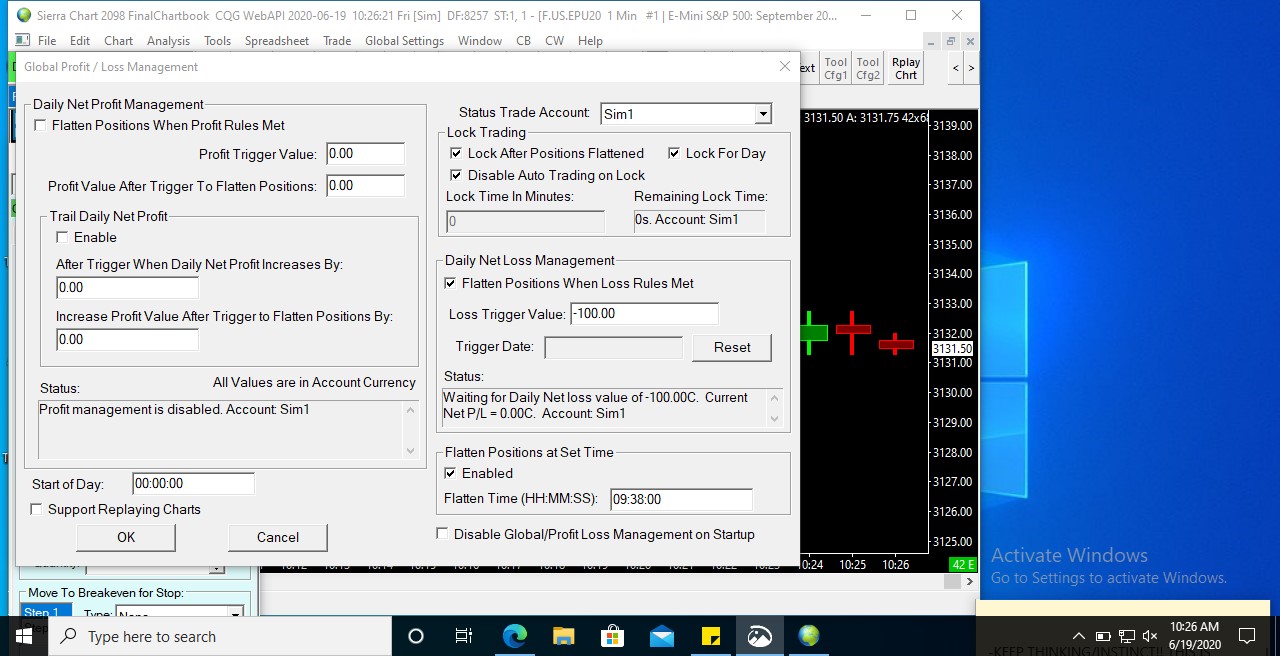

Unfortunately this is not working (not locking when the time of day is reached). I believe I have the global time set correctly and have followed all other steps you gave me. Can you please see the attached screenshot/file and see if you can determine what the problem is?

Based on the Profit/Loss amount (0.0), the daily net loss amount was never reached. Therefore, trading was not locked as there was nothing to do.
The specified loss must occur before locking of trading will occur.
Refer to the information here:
Global Profit/Loss Management: Lock Trading (Global Settings >> Global Profit/Loss Management)
Date Time Of Last Edit: 2020-06-19 19:14:26
