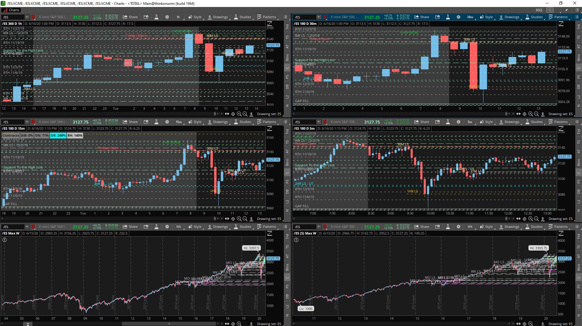

Thanks for the info guys. but sadly this doesnst help me.. Im aware we can detach screens. i was looking to have 1 screen per window with multiple time frames to avoid loading time when switching. Im hoping that Sierra Support has an answer fro me because currently im running TOS for Time based charts and sierra for VP/MP delta usage and would like to switch completely over do all the drawing can line up but im not sure if thats gonna be possible. I uploaded a screen shot of what TOS does and im trying to replicate it per say. this is all the windows in the group and i can maximize 1 and then scroll through .

However I'm having difficulty figuring out how to copy the drawings from instance 1 over to instance 3 and so on a so forth.
This is not supported.
We will have to see next year about possibly supporting multiple Sierra Chart main windows within a single process. That will be possible once we remove the MFC foundation from Sierra Chart that is currently being used.
