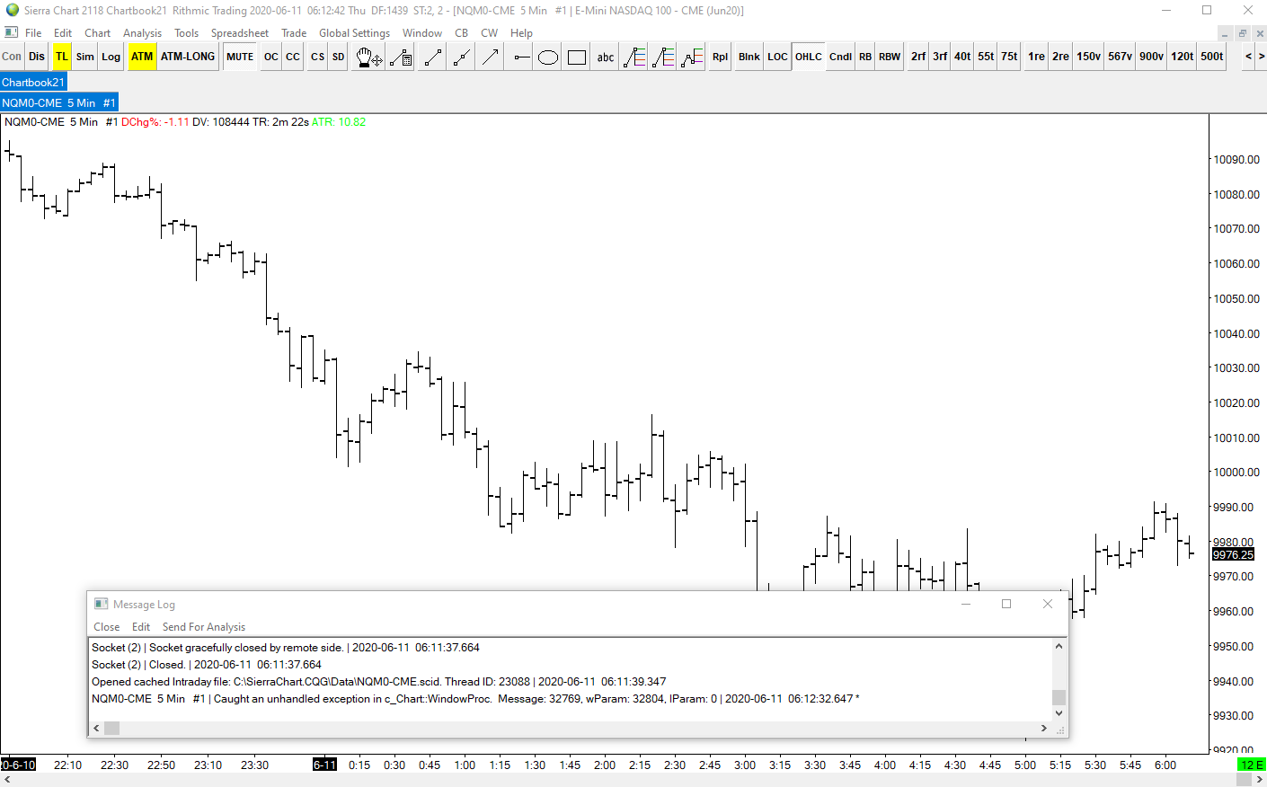

Every time when I add/modify a study AND check the "Save these settings as the default" on the bottom of the study settings window then SC hangs.
See error message on the attached screenshot.
Charts still update continously but there is no way to interact with the program. It can only be shut down from the Task Manager, End Task.
However, the new study is not added to the chart but the new defaults get saved. After the restart and adding the study to the chart uses the new parameters.
imageCapture.PNG / V - Attached On 2020-06-11 10:15:58 UTC - Size: 61.99 KB - 475 views

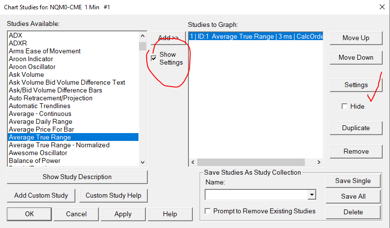

It seems that the problem arise only when the Show Settings (in the middle of the Studies window) is checked, to pop-up the study's settings immediately after it has been added. When this is not checked and the study is set separately via the Settings button (on the right of the Studies window) then it works fine. See attached screenshot.
imageCapture.PNG / V - Attached On 2020-06-11 16:21:42 UTC - Size: 34.9 KB - 454 views
