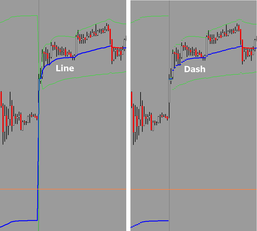

The picture shows the VWAP with two different Draw Styles (Line and Dash).
As soon as there is a change of the day, the Draw Styles behave differently.
Is it possible to integrate an additional Draw Style that has the look of the "Line" but the behavior of the "Dash"?
imageDraw Style.png / V - Attached On 2020-06-06 02:13:04 UTC - Size: 54.4 KB - 543 views

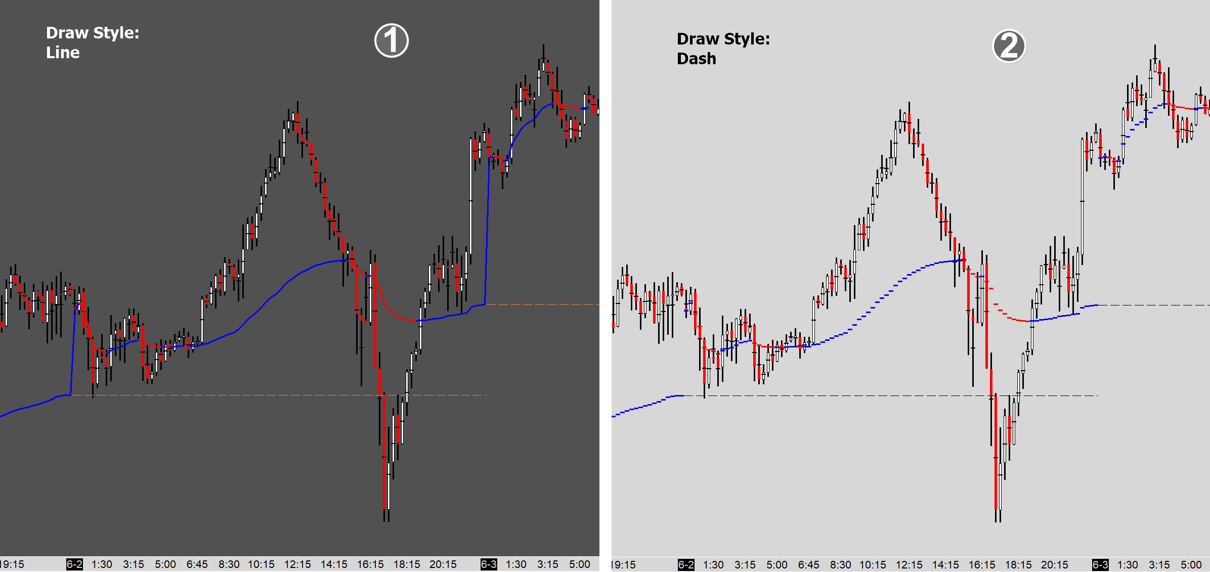

In the attached picture you can see that the Draw Style "Line" has strong "problems" as soon as there is a gap. Dash behaves much better, but visually not as good as Line.
imageLine vs Dash.png / V - Attached On 2020-06-08 08:36:41 UTC - Size: 15.62 KB - 581 views

what do you require in the first post happens in your study only at the beginning of the session?
It would be a solution by another study to insert "zero" at the beginning of the day and use the DRAWSTYLE Line-skip Zeros. I will create a universal study to restart ... it will be usable for all studies ... it will be available for download at night on the CZSK forum.

The solution given in post #5, would be the right way to solve this.
There is no new Draw Style that could be added to solve this. It has to be solved at the study level. The source code of that is available and can be modified.
