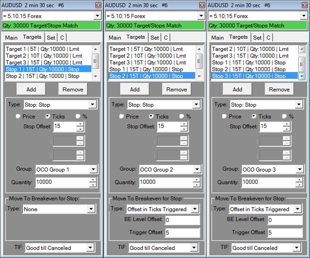

Have just noticed: my Live Bracket-order triggered & moved to break even but my (same tick) Target1 order only got triggered (filled) when market moved a few more tenth of a tick further. Why?
Question: When are Stops, Limits & Move-to-break-even triggered (and how are these correlated) in Live trading, are they triggered all the same based on what, Bid/Ask/Last (in a Long position)? I assume (and in real life) once the market moves through the Ask (if long) but how is the break-even triggered?
In my understanding, if a bracket order is pre-configured for the Stop to move to break even when Target1 is filled (ie T1=5, BE trigger=5) then these should be executed at the very same time, actually I'd expect for the Fill to occur first then the move-to-break even; is this so?
I've attached screenshots so you can better ascertain.

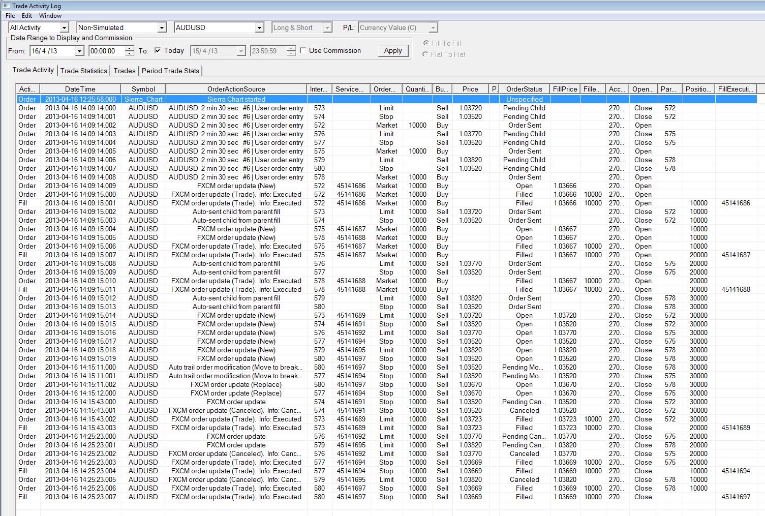

And/Or could it have to do with how SC handles tenth of ticks (AUDUSD 1.03666), as in the Trade Activity Log it appears some entries labeled Stop/Limit/Market are rounded to the 4th digit while others are expressed as 5 digits (1.03660 vs 1.03666). [my 2.30min chart value scale is configured to show 5 digits AUDUSD]. Furthermore, my Order Fills (see attached pic), entry price is 1.0367 and T1=1.03723 (profit =5.6) but my bracket-order Target1 is set to =5; can you pls explain?

For the Move To Breakeven settings on a Stop, you need to set the Type to OCO Group Triggered. Refer to the Attached Orders documentation.

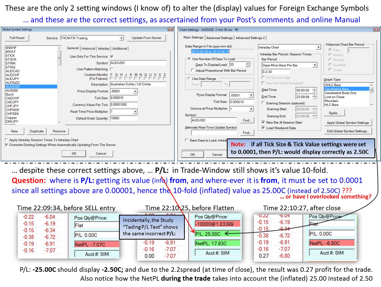

It looks like the only outstanding issue is with the Tick Size. Why do not you increase it to .00001 in Chart >> Chart Settings.
[2013-04-18 04:24:25]
Rainer - Posts: 112
Ok, in SIM mode the increase Tick size appears to work. But this meant having to increase the Target/Stop values 10-fold (a 15 Tick Stop now needs to say 150, etc.), and my P/L now also shows the value 10-fold ($36.00 as opposed to $3.60) but when Trade is Flatten, the Log does show profit as $3.60.
5) What other settings can we set to off-set/compensate this increase in Tick Size so that we don't have to compensate for this increase in Tick Size and see all values (P/L & Lot size) as 'proper' values?

Rainer - Posts: 112
Ok, long story short, just realized what you were actually (in your first reply) referring to with:
; not realizing when your replies pertain BOLD lettering, it actually refers to window selectable (related) parameters; not just highlighted text.
Anyway made the changes and it works like a charm; (u may keep the pdf as a souvenir)

Please refer to the Global Symbol Settings documentation here:
http://www.sierrachart.com/index.php?l=doc/doc_GlobalSymbolSettings.php#top
Refer to the Introduction.
And also refer to the documentation for Tick Size and Currency Value Per Tick. They have been updated and should answer your questions in regards to the subject. Be sure to refresh the page.

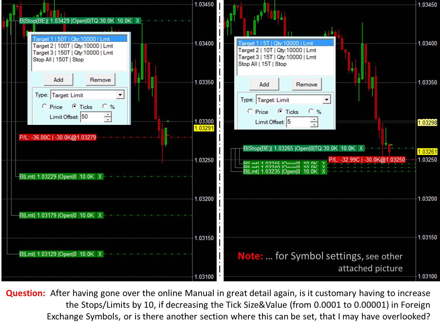

... have re-read online manual in close detail and understand the relationship between Tick-Size & Tick-Value (in Foreign Exchange Symbols) and altered settings accordingly, but the results still produce incorrect values as far as ...
1) P/L: display in Trade Window
2) Bracket Order Tick size settings
Can you please refer to the attached (very detailed) presentations with specific to the point questions?

1. Check the Currency Value per Tick in Chart >> Chart Settings >> Advanced Settings 2. After changing this select Chart >> Reload and Recalculate.
2. Try using "Price" instead of Ticks. We cannot provide further help with this. This is just how it works. The step will always be in increments of the Tick Size.

1. Perfect, Thanks
2. ... leaving it as Ticks (as it is easier to identify despite displaying it 10-fold)
