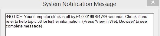

Say my computer clock is off set by 64 sec. I have tried to reset the time and date on the computer but still keep getting this error. On the platform side I unchecked enable FIX logging since it says there could be data error if the time is wrong. I went through support section and did not find this particular issue addressed. I have attached the error message. Can you advise.
imageTime error.JPG / V - Attached On 2020-05-31 13:53:38 UTC - Size: 23.24 KB - 395 views

Therefore, you could not have actually corrected the computer's clock if you are getting that message.
Use this command to correct the time on your computer:
Global Settings Menu: Set System Date-Time from Server (Global Settings menu)
And you may need to run Sierra Chart with Administrator level access for that command to actually correct the computer's clock.
